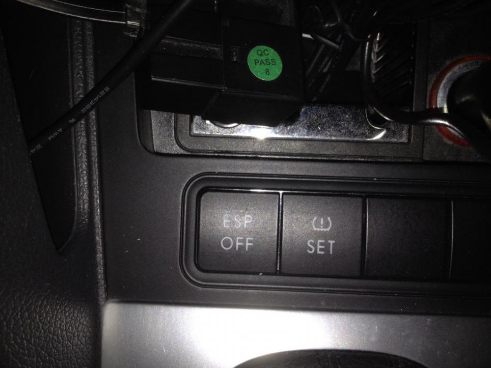

    If you have a button next to the ESP button where in top of your gear stick.
    From the user manual, if you change the tyre pressure which you need to reset it. By pressing it for 5 seconds and you would hear a ding, it will reset the sensor.

      Thanks epigoo
      I knew it was an easy fix. I must have missed it in the manual. Now I have to go back and check
