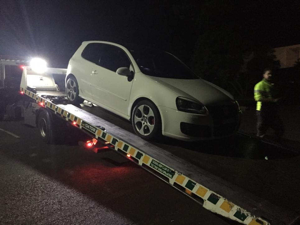

                      RACV will be here in 90mins. We'll see what they say
                        So sad
                          It wasn't the brake light switch? :O Have seen the the signal wire from the shifter module giving issues on one before. You really need to scan it up with VCDS and have a look at some of the measured value blocks to see what is going on.

                              AutoElec has gotten back to me. Apparently the Centre Control Module has failed. He said it is what "wakes" everything up in the car
                              Replacement cost from VW is $2500, but he said he has sourced the relay that has failed and can solder a new one on and program it in for me at a cost of $550
                              Hopefully it all work out
