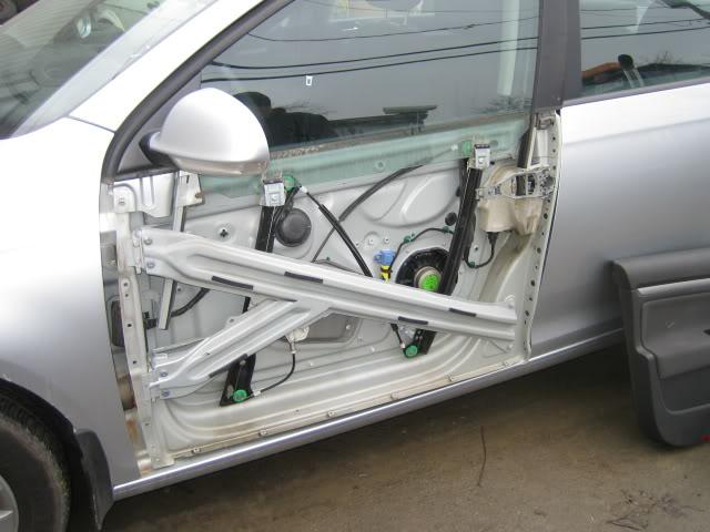

    As the title says, does anyone out ther know the Impact sensor location for the drivers door of a Mk5 golf ?????
    The guy who scanned the car today told me its in the B pillar (between driver and rear door) but it's not. All I could see in there was a yellow sensor attached to the seat belt tensioner. Digging around I found the ones for the rear doors under the sill trims just adjacent to the back seat but the drivers one.................?
    Is it in the door itself (this tech stated it isnt but....?)
    Pull the door trim off. It's in the inner door skin. Bright yellow. Cant miss it.

      Right next to the speaker inside the door.
      Blue module with yellow connector.
