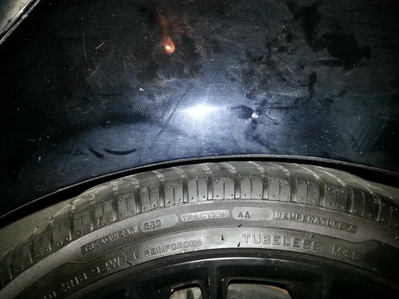

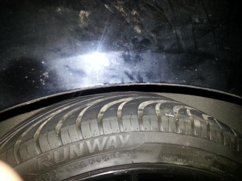

      Photos showing the height difference. First photo is the left side, second is the right
