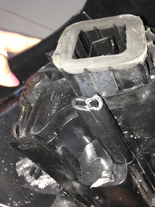

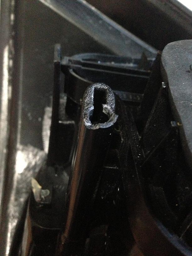

    Hey guys, Just recently washed my car and found out the tail light was loose, moved it abit and it completely came off. I noticed the part where the screw goes into has broken off somehow..
    Is there any way to fix this or will I have to just get a replacement?
    Its a Golf R32 with Perform tail lights I believe
    Would anyone know how much just 1 rhs tail light would cost roughly and where to get it from?

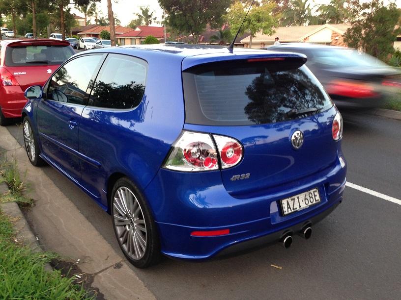

    here is what they look like
    They look like aftermarket ebay specials are they? If so, I'm not at all surprised they broke.
    You could get it plastic welded up, or probably find another pair on ebay for $100.
    If they are aftermarket you will have a hard time finding an individual light. Even the manufacturer will often only sell them as pairs

          You could get some araldite and a plastic wall plug and glue it in , cut it to the right length ,no one would be any the wiser .
            I have no idea what plastic welding is worth, as I've always done my own (and customers while I was in a panel shop), but you might be able to find someone to do it for under $50
            If you have the piece that broke off you could always try to simply glue it back on (use JB Weld or Quik Fix etc)
            But, every set of aftermarket lights I've ever seen have been complete rubbish in quality and fit. NO EXCEPTIONS.
            You would be better off (IMO) finding a decent standard set
