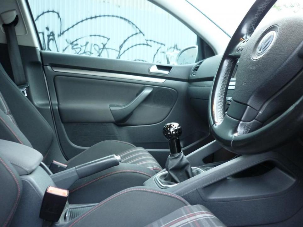

    what i want to know is will the mk 6 golf seats fit straight into a mk 5 golf?
    any info would be appreciated
    Yeah they will. They're essentially the same floorpan.
    Only concern would be with the seat airbags.

      i have now fitted a set of mk 6 gti seats into my 2.0 tdi and they fitted perfectly as well as the wiring connectors.

          No airbag dramas?. Also - just fronts or both fronts and back seats?
          Platinum Grey mkV Jetta turbo, Viezu motorsport map, GT-CX 18", lowering to come
            no airbag problems that i can see.
            and i fitted front and rear seats.
              mk 5 golf interior question
              Nice. Really want to do this down the track. I'm guessing these are the manually adjustable seats?
              And just how much better do they feel?!
              Also - belt wise do they all fit? I've changed seats in a different car (not vw) and the belts would not clip it.
                these are manually adjustable seats.
                i think that they are much nicer than the standard comfortline golf seats. they definitley feel better..
                seatbelt wise they work fine. i used the original mk 5 retractable part and the mk 6 ones that were already on the seats.
                i was expecting problems , but didnt run into any, i suppose it would be the same for any mk 5 if you wanted to put mk 6 seats in...
