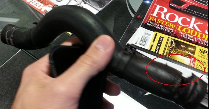

    I get a call at 5:00pm from Dean that the guys have isolated the leak, it's coming from the cooling hose which connects up to the rear of the cylinder head. They've also performed a pressure test on the cooling system and compression test on the head (rest of my cooling system is OK and my head gasket is also OK). They're going to order in the hose and also a new coolant reservoir and flush the entire cooling system. They hope to have the parts delivered the following and the car ready by 5:00pm the next day.

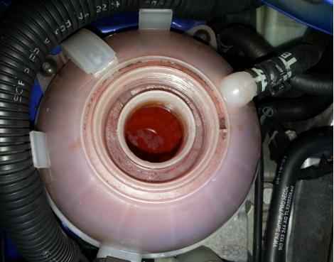

    Over the past 2 years my coolant has had a (bad) habit of becoming contaminated/rusty/orange look to it with fine grainy sediment in the coolant reservoir, took back to the dealer back in 2011, no fault found was the diagnosis, with the comment 'someone must have used the wrong coolant which has contaminated the coolant' the Standard Spiel you get from the dealer.... I had topped up the coolant approx 6 months prior to taking it to the dealer in 2011 as it was low.....using G12 coolant, bought from the dealer......(used the wrong coolant, yeah right). So I took it to a local workshop and had the coolant flushed and coolant reservoir replaced. Approx every 6 months or so, I'd have to top it up.... but my coolant was never a bright pink colour, there was always some signs of contamination left behind.
    This is what my coolant looked like after my 75000km service: (less then 2 weeks after being flushed)
    This was the hose: (I'm pretty sure this is the source of my coolant being contaminated....it had a lot of the orange sediment bits inside of the hose near the crack (circled on the right in red).

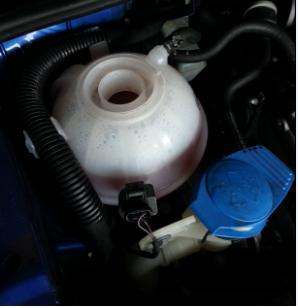

    This is the new coolant reservoir: (nice and clean!!!)
