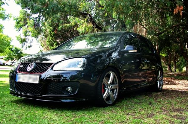

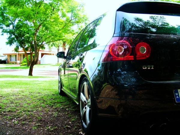

                Any pics Andy?
                Platinum Grey mkV Jetta turbo, Viezu motorsport map, GT-CX 18", lowering to come
                  Originally posted by audi-tone View Post
                  Any pics Andy?
                  Yep sure. Here's a before and after. No scrapes as I go over speed humps, but I'm definitely too low the front lip to clear parking sleepers or a car park kerb. The wheel gap is now just a bit less than one finger
                  Before
                  After
                  Check out MKV photography thread for more
