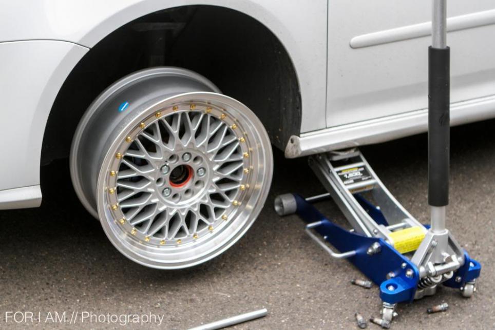

    Got heaps of requests to do a thread for these wheels,

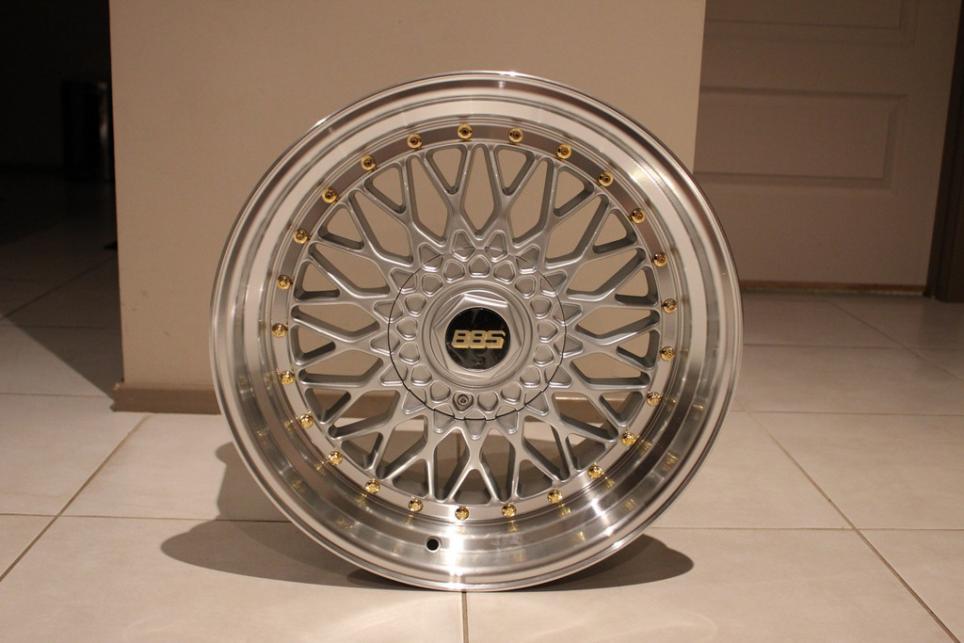

    These are BBS RS reps, 18 x 8 front 35et 18 x 9.5 rear 40et

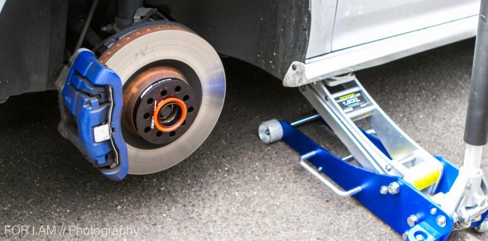

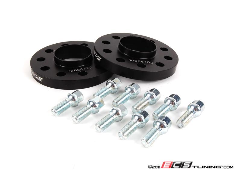

    Everyone thought the rears would be the problem, they fit on with no trouble. The fronts on the other hand, hit the break callipers. So some hubcentric spacers had to be purchased. 17.5mm spacer with some hub rings.
    Spacers arrived today and thought I'd try them on without tyres just to be sure. And all was well, tyres will be fitted tomorrow and I'll update the final shots when it happens.
    With the spacer and ring.
    All is well.

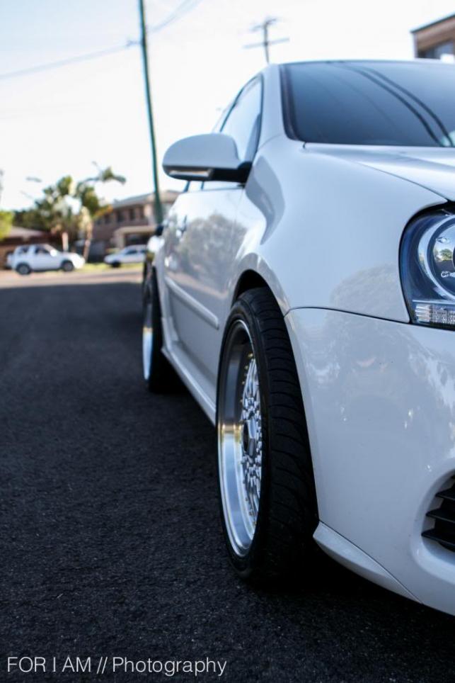

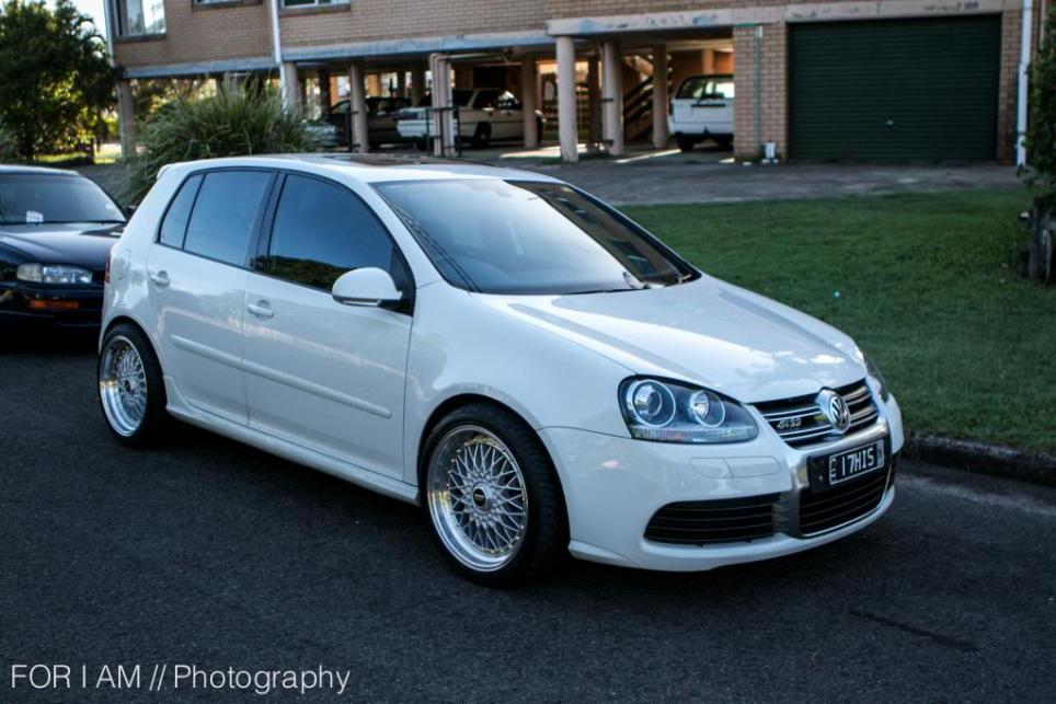

    And they're on.

      Duh spacers are illegal - all I care about is if they are safe with your lug nuts !
      Btw please use a jack stand to support your car when working on it ! Safety firs :0)

        haha yeah, so is the wheels hanging an inch out of the guards. There will be plenty of mods I do that are illegal. Doesn't phase me. We live in the most over regulated country on earth, not going to stop me.
          Yeah I've got extended bolts, it's fine.

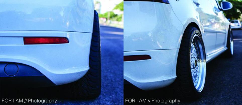

              Cheers Robbie, it'll look better when I widen the arches out.
                Why are you widening the arches?
                Pity you had to put spacers on the front, really makes the offset too low.
