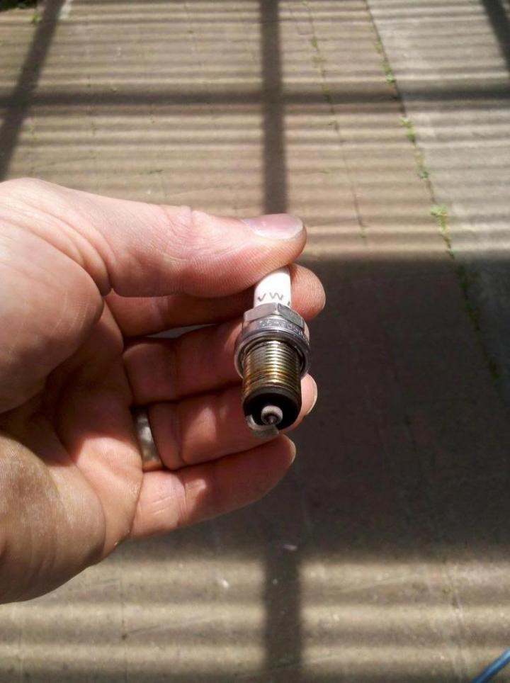

      I replaced our plugs last week.
      Here's a Picture.
      They gave us 40,000k's and showed no driving issues. I just replace things as i please before scheduled intervals.

        That's how mine look, but instead of 40,000km, they have only travelled 10,000km. should I be worried ?
        here is some pictures of 2 of the spark plugs
          Nice brownish tinge there, spot on, no need to change and should be good for 60K

            I would have thought slightly rich. but then again, I'm not an expert. although.... I'm not a fan of that type of plug.
              Yeah maybe a tad but on the electrodes has a nice brownish tinge, nothing worrying there really. yep wierd plug on the NA motor
