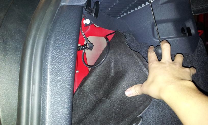

Begin with taking the LEFT outer tail lights off the car. This will give you more room to manoeuvre, plus you'll have to wire the inner LEDs to the plug in any case. This is a simple matter of peeling back the trim in the boot at the sides and undoing two bolts and unplugging the lights, if you don't know how to do that there’s plenty of guidance on this topic, do a quick forum or google search. You may leave your right outer tail lights intact.

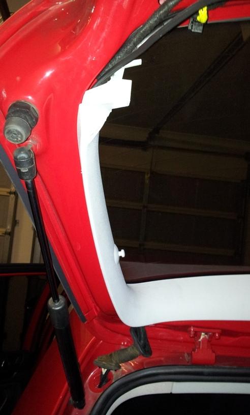

Take your wire (positive and negative). Get a flathead screw driver and pry open the bottom corner of the white plastic cover (you can see the pry marks from where I did it in the picture above - you should probably be more careful
) enough so that your wire can squeeze through. You may find that you need to pry it until a clip pops loose, depending on how thick your wire is. Alternatively you could remove the whole trim, but I couldn't be bothered to. Then you need to thread the wire through downwards, enough so that when you put your finger through the hole where the rubber grommet for the connecting tube was, you can feel the wire. Once you can hook your finger on the wire, thread it through the hole and yank it down until there’s enough length to reach down to where your outer tail lights are.

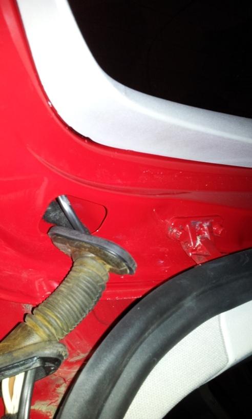

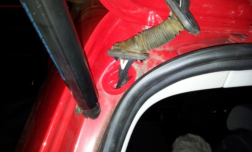

With that done, now we move on to the most difficult part of the wiring. You have to thread the wire through the bottom hole where the rubber tube will sit over, into the side of the boot.
Here's where it has to go through:
And here's where it has to come out:

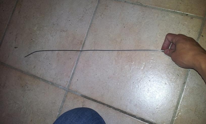

There are several dead ends through that path that you might hit so this will take up the bulk of your time. A rigid metal wire here is really essential for this to work. The wire needs to be rigid enough that it is difficult to bend out of shape by hand and use of pliers may be required. It helps if when you're poking the wire through, it is bent at the tip slightly towards you, like so:
Poke that wire through the hole at the top of the boot body. When you get stuck, move it back and forth while wiggling it a little until you feel it sink deeper (I know what you're thinking you dirty bastard). Mine got stuck at about 3 or 4 different "levels" before it successfully broke through. You'll be able to see it clearly in the space where you peeled the boot trim back - if you can't, don't go groping for it in hopes of finding it - you most likely poked it through the wrong path and you'll just reward yourself with cuts on your hand.
At this stage if you decided to give up on this method you can still carry on with TDI_DSG's method of poking a hole in the rubber connector tube and the rubber seal around the boot body, threading it through to the space where it needs to be. You'll need to seal the places where you poke the hole. Pictures of this are in the next post.
If you succeed, once you're through with your metal wire, tape the end of your electrical wire to the end of your metal wire and pull the whole thing through. Make sure you have enough overlap i.e. at least 10cm of of the end of your metal wire should overlap with the end of your electrical wire, where it's taped - if your electrical wire comes loose from the tape when you're pulling it through then it's back to the beginning, to thread your guiding metal wire all over again.
