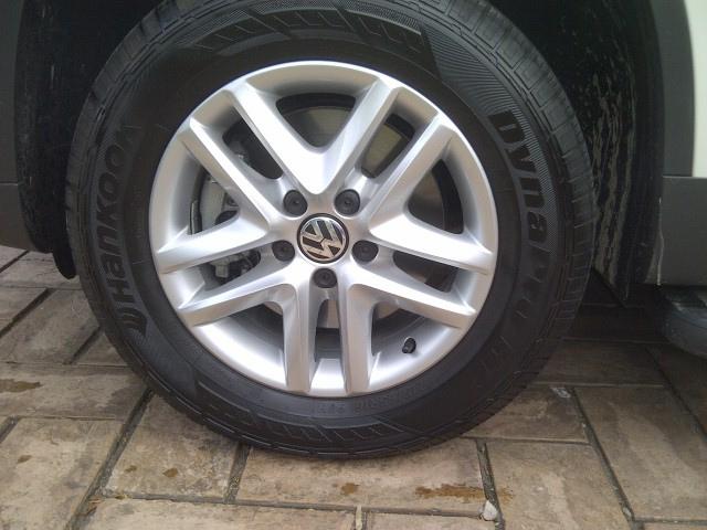

I'm pleased with the results; clean wheels, the same or better pedal feel and the brake discs should not need replacing for some 200,000km, at least that's what some reports.
ATE Ceramic pads installed day 1

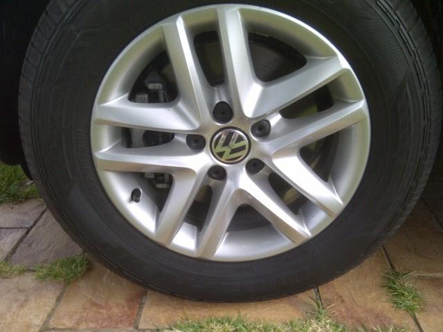

2 weeks 450km later
I will not wash them for 2 months to see how clean they stay, but so far only dust I can see is the same dust and dirt as on the rest of the car, we also had some rain in Adelaide in the past 2 weeks.Performance Tunes from $850Wrecking RS OCTAVIA 2 Link

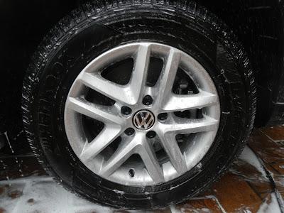

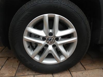

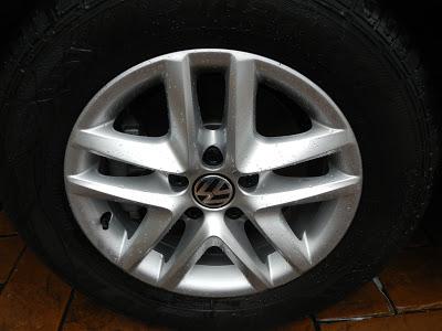

Well, wife parked under the trees and I had to wash the car yesterday. The wheels were very clean, no black dust and I just washed them with the high pressure cleaner.
Before wash
After wash
Finally, I don't have to use the sponge or brush on the wheels.Performance Tunes from $850Wrecking RS OCTAVIA 2 Link
