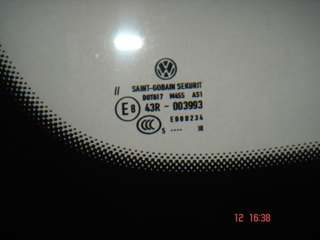

      Also the Vw windscreen is heat reflective , if you have glass cover it wont cost any more .

        I've heard ONLY the mk6 is heat reflective...the mk5 is not. Yes/No?

          THis is what should be on your windscreen the IR means reflective
            Ian, thank you. I shall relay that tomorrow. Appreciated. My Golf is 06, but VIN has it 07. I've learned VW get the parts by using the VIN.
