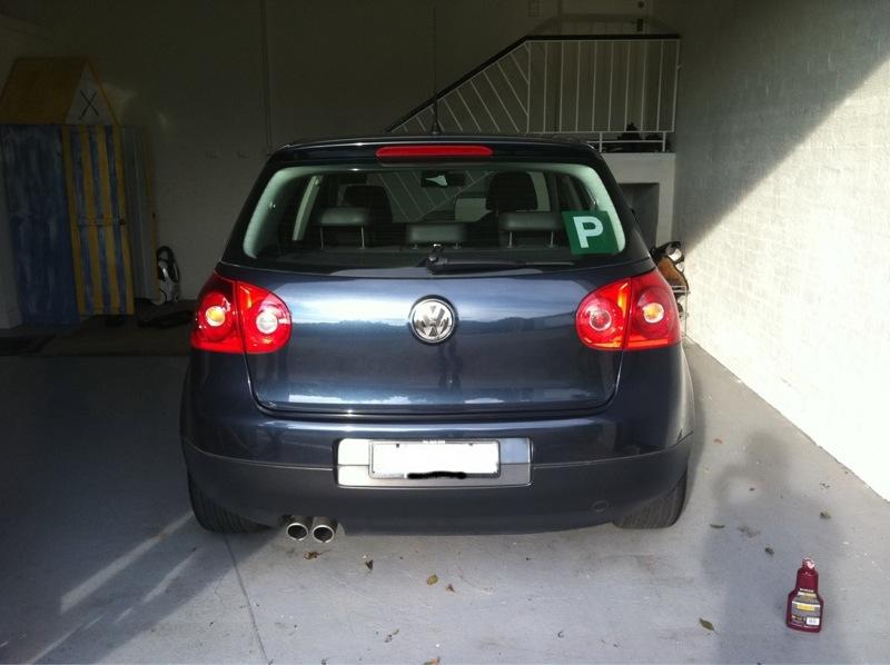

    Well I did this quick photoshop, if anyone can do better let me know, but what do you think, should I get them?
    this is me atm

    10 out of 10 for your photoshop skills and hell yeah
