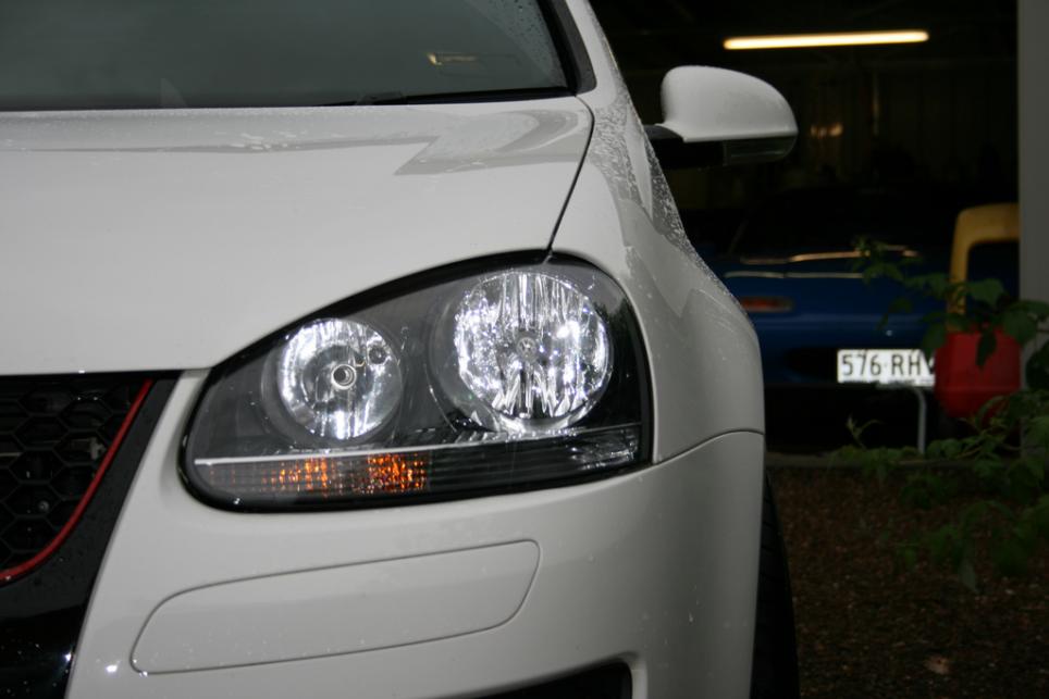

    i have the same problem, one is nice and shiny from a minor prang/ insurance claim. the other is scratched and dull. i have found gti halogens on ebay for 180+ 60 shipping. very good price and they look much better than the stockers. food for thought. i think the halo/ r8/ebay ones look like sh!!t

      DON'T touch aftermarket headlamps. They are awful. As Lowtdi said OEM stuff can be found fairly cheap.
      First port of call though should be calling a detailer to hold his polisher down on the headlamps for a few minutes. This is what my wife's Astra looked like, before and after.
        You don't have to go to the extent of replacing your headlights - the originals can be repaired very easily yourself.
        Just get a bottle of PlastX ($29 from AutoBarn) or a similar plastic polish to remove the micro-scratches.

                Just a note for anyone thinking of doing it, you NEED a buffer, I tried it by hand and it was hopeless. even after the first 2 goes with the buffer it still wasn't really making much difference on the worse areas. I ended up using 1200 sand paper over the entire light and then it took about 30mins of buffing, cleaning, buffing, cleaning ect ect - improving on every go. end result is very good.
