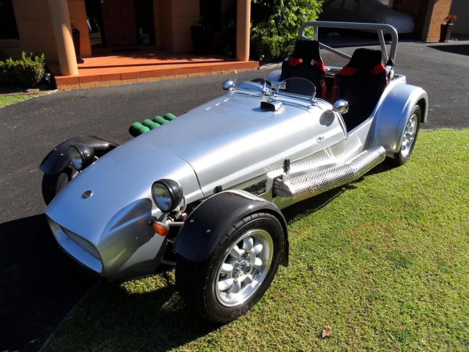

                      would this intake pass in Qld?

                        Hahahaha that's f'n awesome!
                            Thanks mate. I guess it's only a matter of time before I get pulled up for them. In the meantime, an extra 7 kw is nice.
