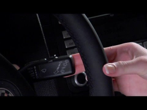

      For those who dont know
      Golf GT Sport TDI
