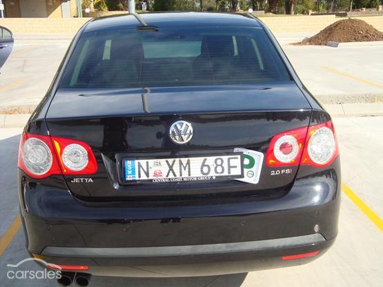

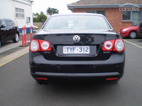

                      As someone else said, earlier model 2.0 Turbo were badged just as a 2.0 FSI, both the 2 black Jetta's below are 2.0t turbo's.

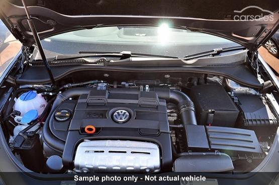

                      The later 2.0 Turbo adopted the red FSI so its easier to distinguish -

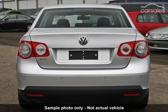

                      To make it even more confusing the 1.4tsi Jetta ( 118 ) is now badged just TSI -

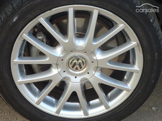

                      The easiest way to tell is by the wheels if you have the 17" wheels which look like this then you've probably got a 2.0 turbo
