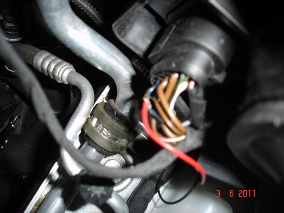

    2) Does anyone have an easy access point to a 12V Ignition wire in the engine bay?
    Is the fuse/fuse holder that's circled in blue to be in series with the 12V ignition connection?
    Do I cut the looped wire in half and connect one end with a spade connector to connect to fuse box and the other end solder to DRL red wire?
    The fuse holder looks like it clips onto something...fuse box?
      Ive installed some DRL'S in my GT there's an ignition wire in the R/H headlight plug , thats what i used
        you can check it out on What did you do to your Mark V today
        page 41/ thread 326
        Gday Ian, thread 326 doesn't seem to be your thread? Can you provide your link?
        I've got Xenons and not sure I'll have the same ignition wire?
        Do you have a pic of the electrician's splicing?
          Sorry mate page 41 post 814
            Thanks heaps for taking the photo!
            Will be giving the install a shot today.
