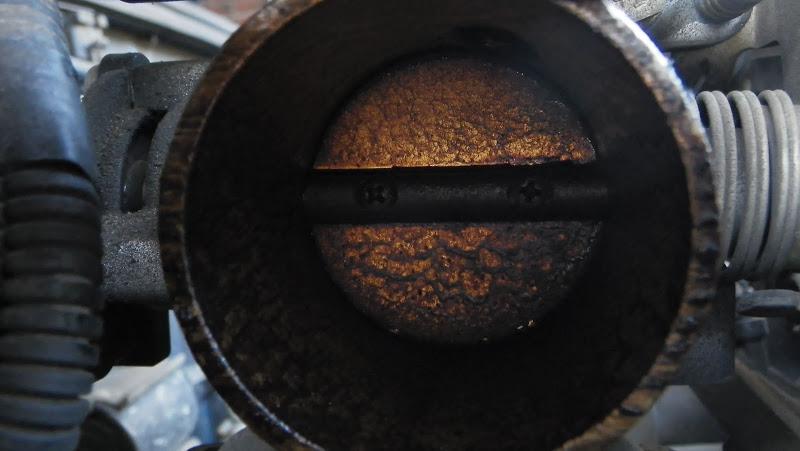

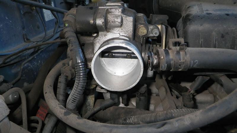

                It depends how long you want to keep that car, if you'd sell it before 60,000-80,000km don't worry about it too much.
                But even ordinary Nulon TB cleaner when sprayed into the intake give this result.
                Before
                After
                So, there is definitely some benefit.
