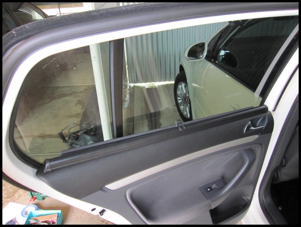

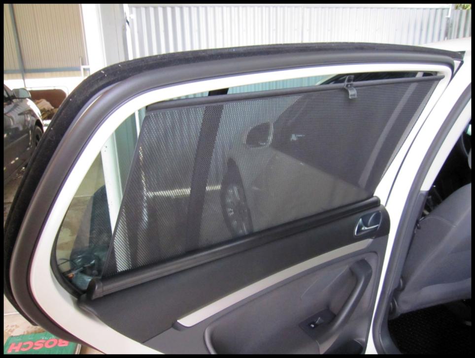

          I have the roller blinds fitted to our Mk V.
          Retracted.............
          Raised into position...............

            thats what i was looking for, was it dealer fit new or something you've put on.
            you wouldn't have a part number would you ?
            sigpic2008 Candy white GTI DSG - 1990 mx-5 loud, rough, uncomfortable but still an amazing car
              I bought it through spare parts. You shouldn't have any trouble getting it (them) as I believe they are available for the MK VI.
              I'll see if i can find the part number, but you shouldn't need it. Ask for the rear door blinds, also available for the rear window.

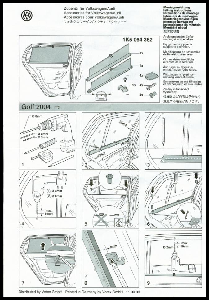

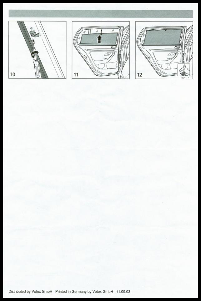

                  A pain to fit. I'll reduce the instructions for you, with a part number.
                  Maris
                    Uploaded with ImageShack.us

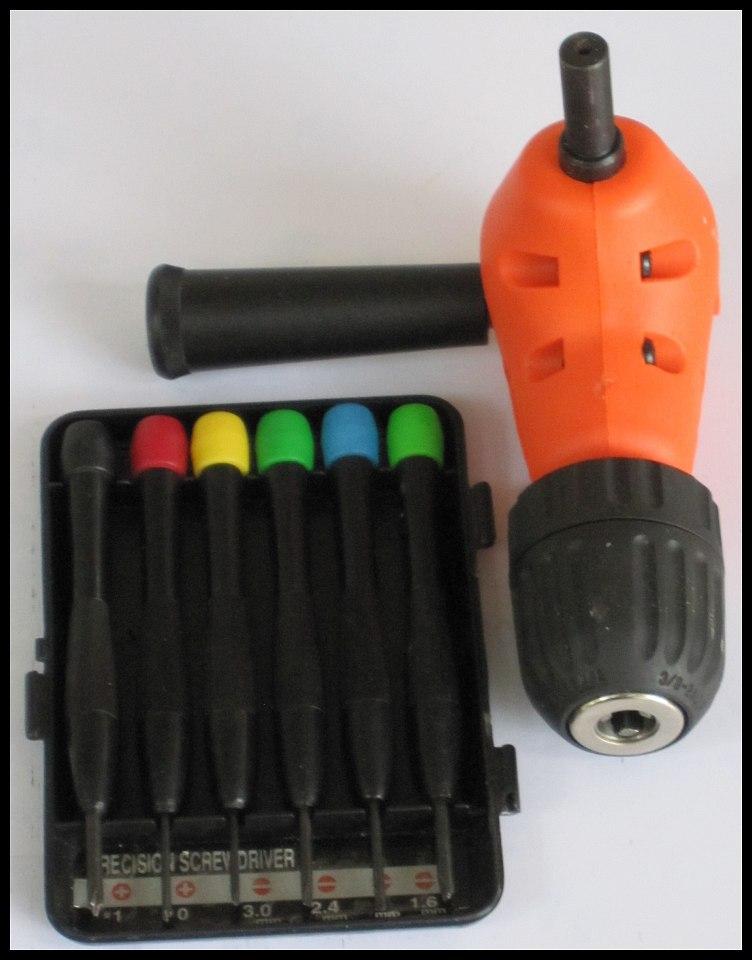

                    Tips;
                    1. Use a right angle drill adapter to drill the holes, as it's a very tight fit.
                    2. For screwing the holder to the door, use the small jewlers screw driver that you buy at the cheap shops for $3-5. Again, very tight.
                    3. Get a friend to help, someone who is good with his hands building or assembling.

                              Here is a pic of the two critical pieces of equipement. The right angle drill attachment allows you get into the corner much better. I think I paid around $20 from Bunnings.
                              The other is the jewelers screw drivers set. This once again allows you to get into the corner and apply the right amount of pressure to the screw.
