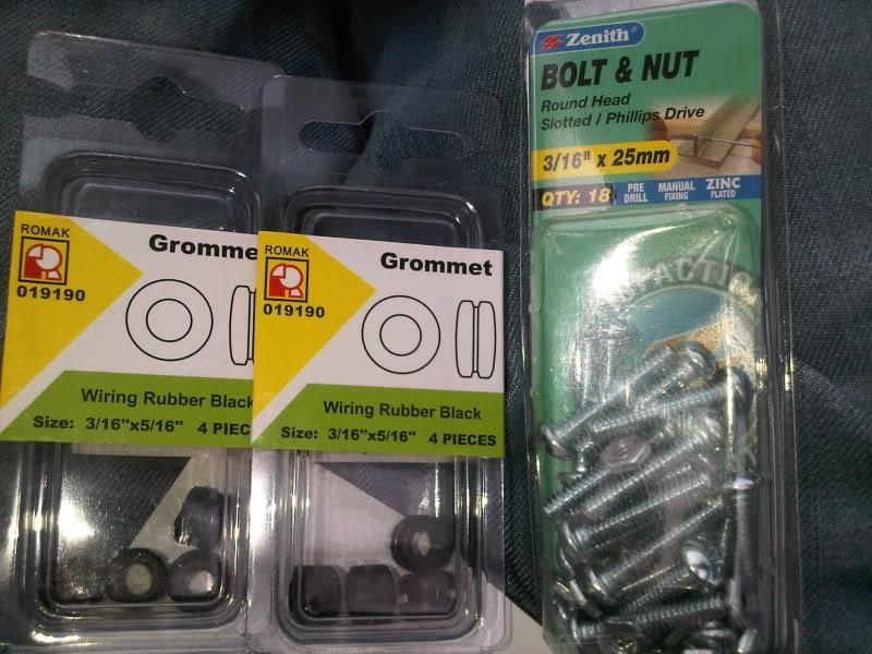

Screw drivers
3/16 screws x8
3/16 bolts x8
3/16 rubber washers x8
Drill
Hand saw
Heat Gun(if you choose to mould the lip)

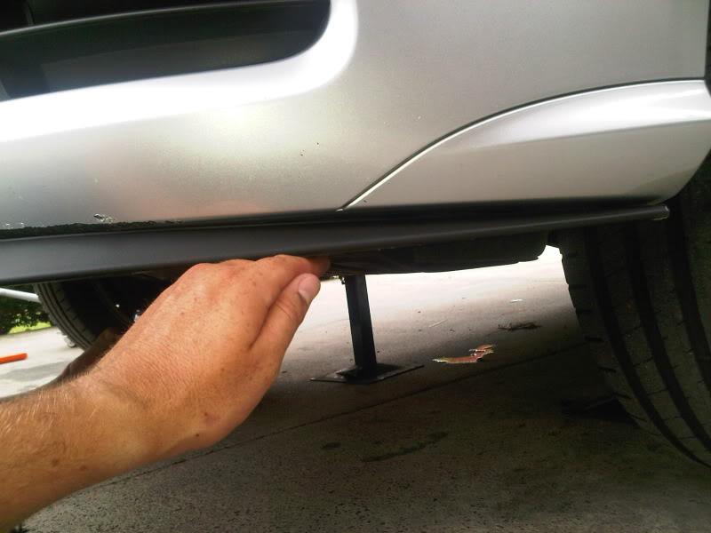

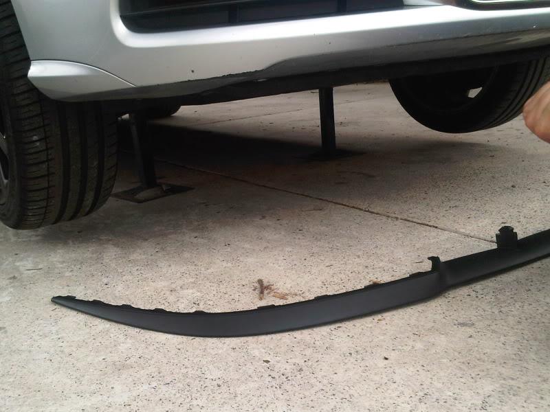

Step 1
Get the car off the ground and jack it up onto the arms under the car using the car stands on each side.

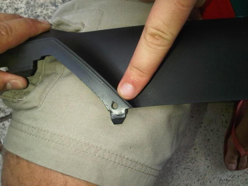

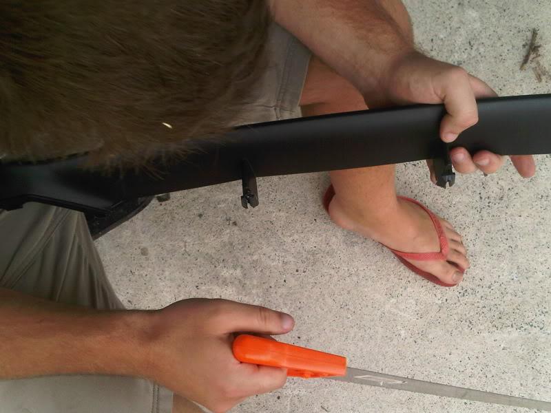

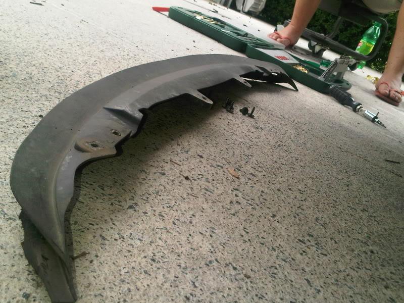

Step 2
Get the hand saw and start to cut back the 2 centre clips as these 2 clips are much too high. So cut them back to almost flush with the rest of the lip and give them a bit of an angle on the back of them as this will make it fit more flush on the bumper. Once they are cut use some sand paper to smooth these cuts out. Once that is done test fit it on the bumper again and if it needs adjustment do it again.

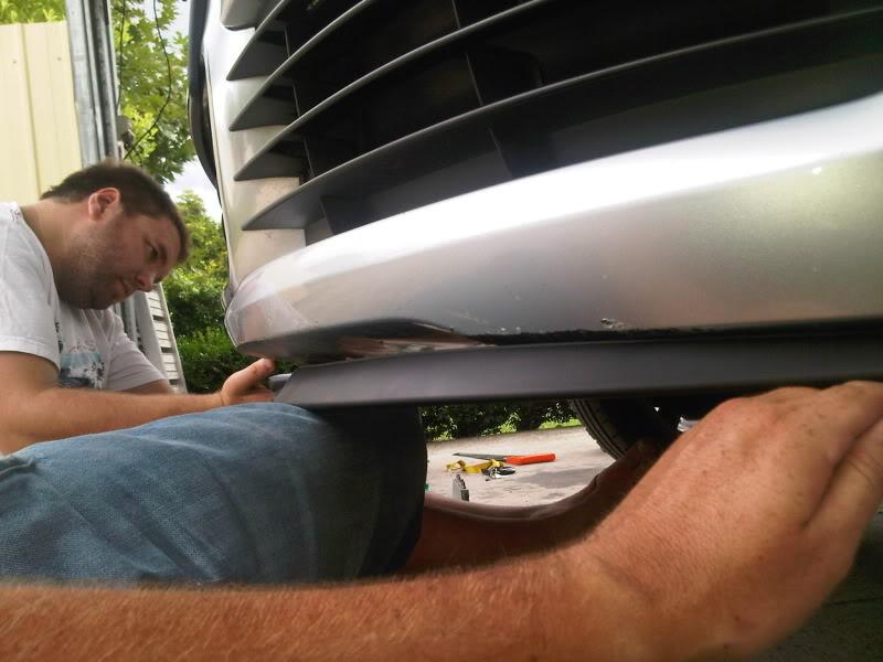

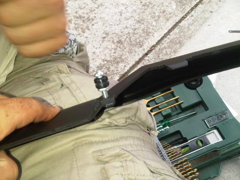

Step 3
Now drill the holes into your lip. Once this is done get a permanent marker and mark 8 points of where you are going to drill for the screws on the bumper, you will need to people who can hold the lip in position while you do this. I made my screw points on the 1st clip from the wheel arches, the 5th clip and the 2 closest clips to the front of the lip, respective on each side of the lip to the centre.

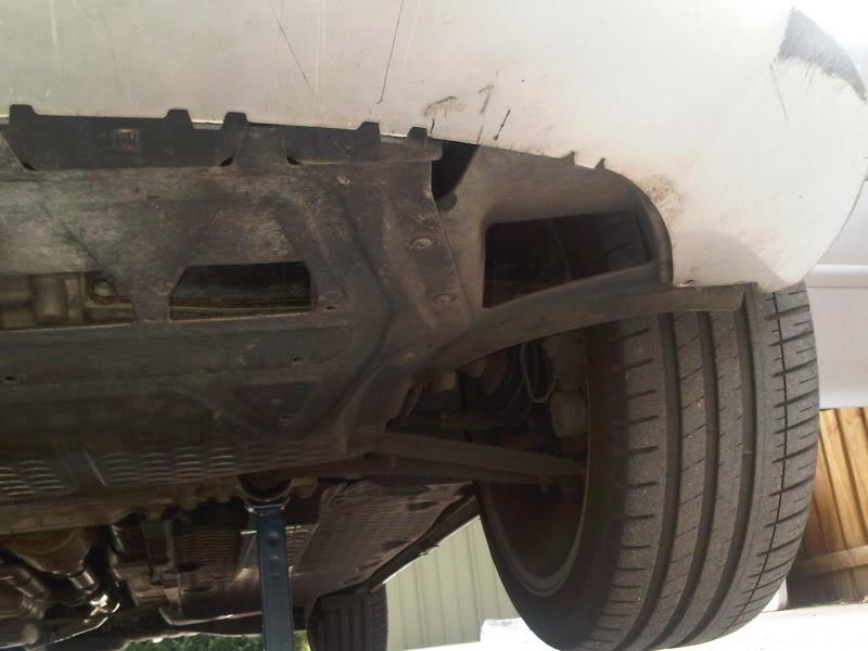

Step 4
Once you have the points marked you then need to get under the bumper to access the rubber panelling between the back underside of the bumper and the under engine covering. you need to remove all 8 star screws and then unclip and remove this.
Step 5
Now drill you holes either 6-8 points depending how high you want the lip to sit into the bumper with your drill. Once this is done start screwing some screws in to get it sitting right and to make sure it sits right. Then you will need to access under the rear of the bumper so you can put the washers and bolts in so it stays on nice and tight. Once this is done you just need to reinstall your under bumper covering and take the car back down to earth. Easy job takes about 1.5 hours or so, but its worth doing it right.

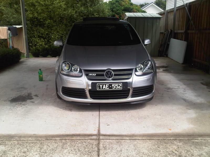

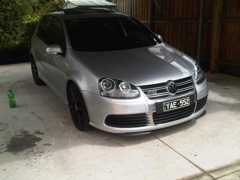

The finished product
