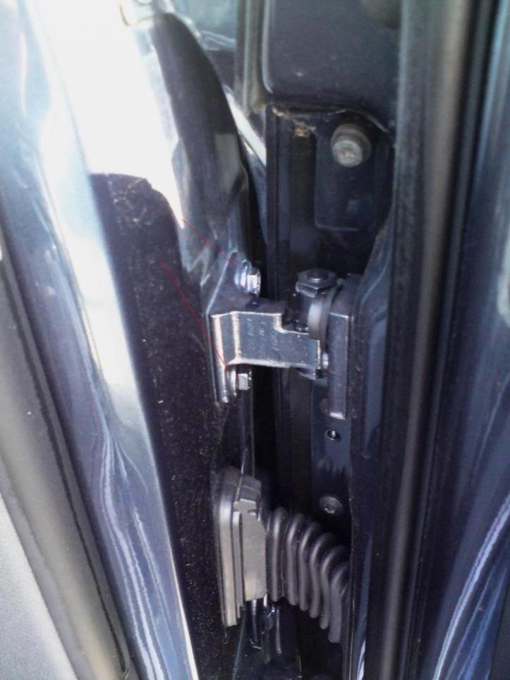

      hi bazzle
      actually was thinking along those lines...except rather than bending the hinges, I was hoping to undo them and then lift using the jack and wood idea
      But...I don't know which bolts I'd need to undo.. Could it just be the two on the top hinge (marked in red in the photo below)?
      or do I also have to undo something on the lower hinge?
      please help....
      many thanks
      S
        There's actually an adjuster on the door side of the upper hinge. You'll need a 15mm spanner and a multispline 8 socket. A multispline is like an allen key only it has 12 sides instead of 6.
        If you have them then you can adjust the door. Otherwise take it to someone who does have the tools.
          many thanks Rob
          that's exactly the info I was hoping for. I'll have a look at the setup and see whether it's beyond my abilities!
