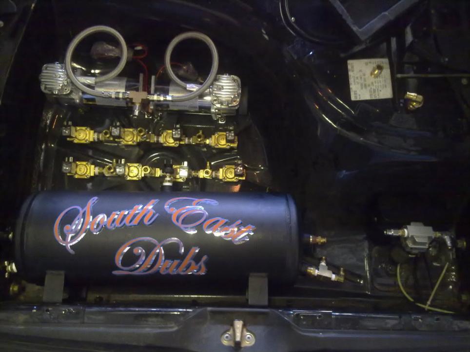

                      as for 2 compressors, they only aid the tank refill... 2 comps means quicker refill... abit pointless to have 2.... i did it anyways hahaha!
                      my setup with 8 valves which gives front back and side to side and 2 compressors....
                      thats how they look covered up! lost no space what-so ever
