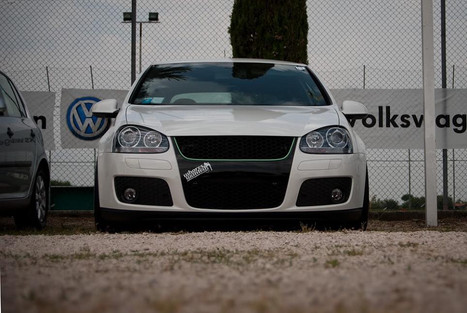

                        Thanks for all the info. I've been searching around all morning, and I think I prefer the GTI front with a badgeless grill:
                        The issue then becomes the notch in the hood. I saw one car that left it there, but his bonnet was matt black so perhaps that made it less noticable. I note that TM Tuning sell a front hood spoiler that fills it:
                        Has anybody else here done this setup?
