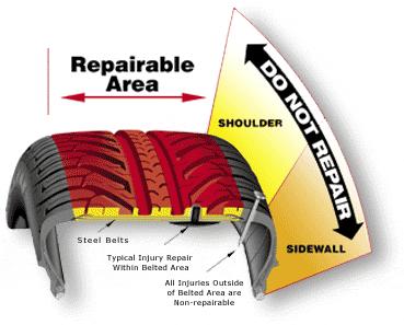

i have repaired lots of tyres with the DIY plug kits.....the sticky black string type of plugs......
and just about all of them are in the same spot as the one in the first post here.....
if they are on the sidewall......DO NOT REPAIR IT....its too thin to hold a plug in place and it also flexes a lot more than the tread area.....
there are always exceptions.....if you are stuck in the middle of nowhere....then you can try to repair a sidewall enough to get you
somewhere near civilisation to get a replacement tyre....but drive SLOWLY cos it may pop any time...... this is only in an emergency life or death situation....
such as being stuck in the middle of the simpson.........for example.....
one of the real reasons for not repairing that tyre was due to the fact....the string type plugs have been deemed as illegal repairs.....
they are only a temporary repair till you can get to a shop to have a proper type of permanent mushroom type plug fitted....
if the puncture is too close to the edge.....the mushroom plug will not sit flat and will flex around and may come unstuck.......

I had a fairly bit puncture in the repairable tread area in the past but was probably beyond repair due to the diameter of the metal pin that went in. Also better to be safe than sorry with things like this or you could get a blowout and easily damage a rim.Last edited by G-rig; 03-01-2010, 01:17 PM.
