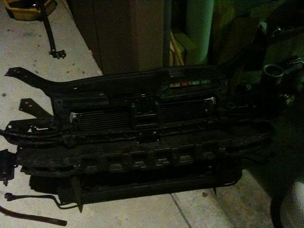

To assist in the removal of the engine from the car, the whole front section was taken off (bumper, headlights, radiator/intercooler etc.)
Misc. parts from front of car and engine bay

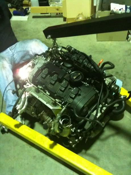

The engine was removed with a engine hoist and supported underneath for extra precaution with a trolley jack.

Engine out of car
AWE KO4 Turbo

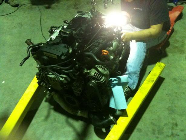

With the engine out, the next step was to remove the DSG gearbox from the engine block.

DSG GB
The engine will be getting Arias pistons and Pauter rods. The head gaskets and bolts will be replaced with new items.

Engine out of car
AWE KO4 Turbo

DSG GB
