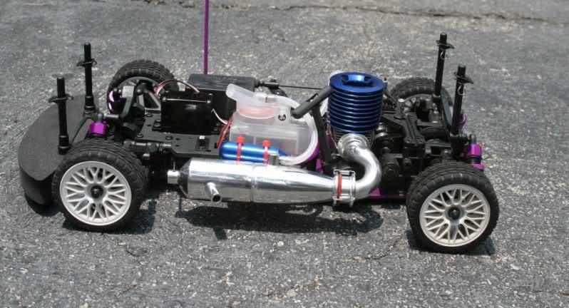

                Already in development!
                  That's the exhaust for the 1.8 we only have 1.4's
                  *Disclaimer - Don't rely on me, seek your own professional advice. Audi R8 E-tron. 230kw 4500nm! (not a typo).
                  Economy at 100kph =5.5L
                    Hahaha.
                    Cog, it still burns.
