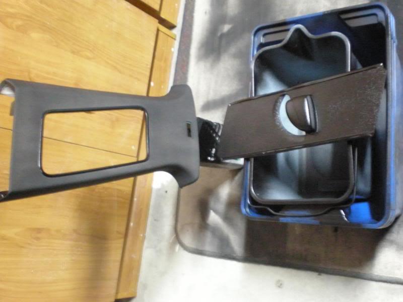

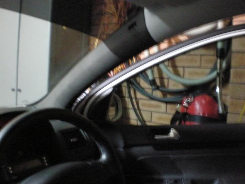

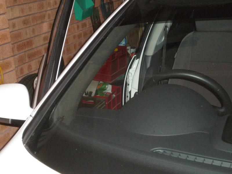

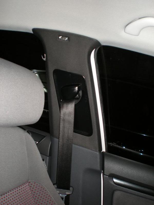

    VHT Vinyl Dye Black... Great product goes on so nicely. Like your spraying black talcom powder on it. No runs, no Drips. Soaks into fabric just like you want it too. Several light coats gets a nice even colour. You can paint the plastic and the trim together, though for the B pillar I took the middle bit out by pulling along the long edge of the bit that moves up and down to pry it out.
    RESULT
    Installed B pillars now! Looks amazing inside.

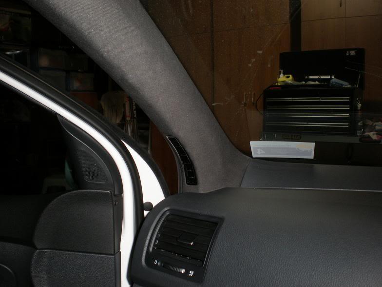

    Nice work. Thats a really good job. Do you plan on doing the whole headling or replacing the headlining to match? Thats one thing i hate about my R is the whitish coloured A pillars and headlining. I am slowly getting used to it though.
    The .:R Registry
    [/FONT][/SIZE][/COLOR][/SIZE]
      Hmmm I think I will paint the other pillars to match and thats about it.
      If I fit some leather seats I might bother doing the whole lot and buy some anthracite handles and bits and pieces.
      You can reuse the airbag clips, just sprayed them and the airvent gloss black.

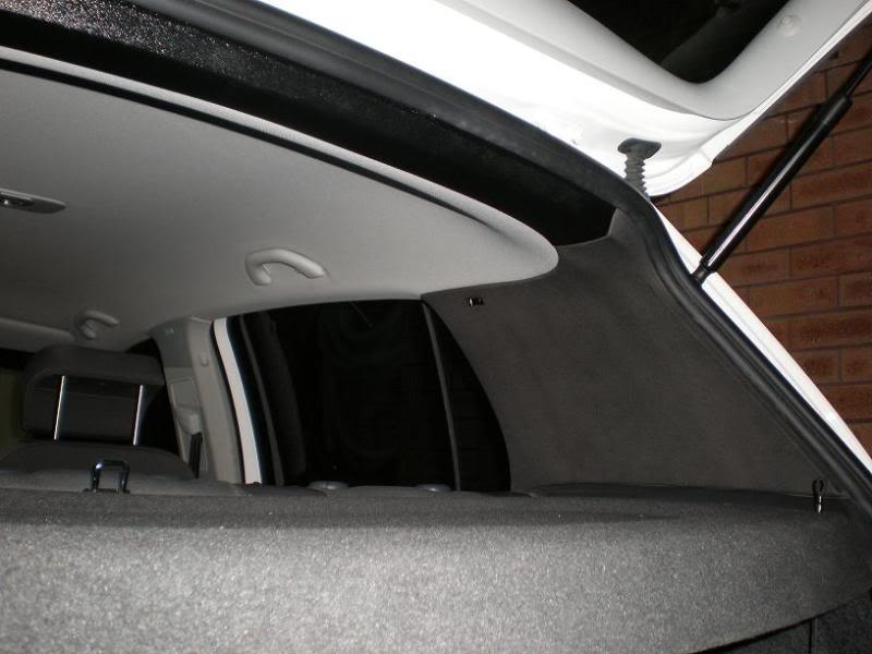

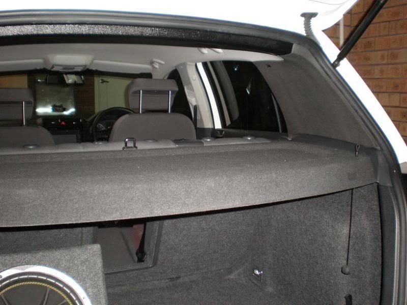

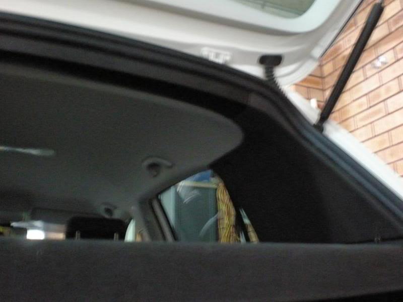

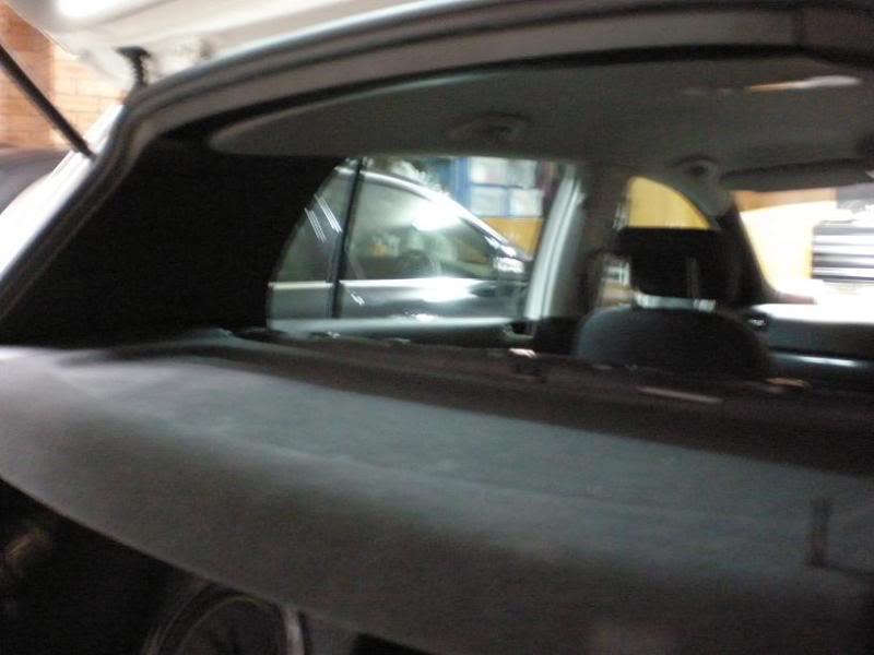

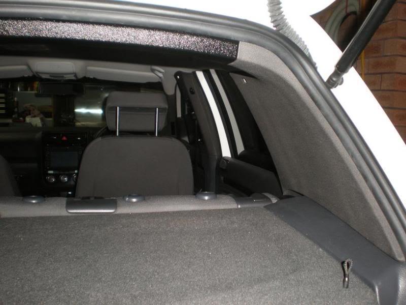

                        I did the back pillars and the plastic trim, also using the VHT Vinyl Dye paint. Worked a treat on plastic too!
                        *Disclaimer - Don't rely on me, seek your own professional advice. Audi R8 E-tron. 230kw 4500nm! (not a typo).
                        Economy at 100kph =5.5L
                          "I did the back pillars and the plastic trim, also using the VHT Vinyl Dye paint. Worked a treat on plastic too!"
                          What what what, rear seats back in?
                          And what's with that super heavy enclosure and subwoofer?

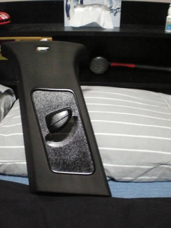

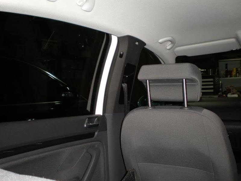

                              B pillar finished
