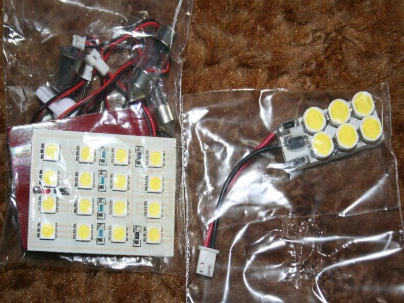

          these are the type of boards i used, many different sizes.
          each of the yellow modules has multiple SMD led chips on it.
          these WILL blind you if you look at them while powered up.(ask me how i know this )

          so as you can see, with good decisions, you can have LED interior lighting that's brighter than stock.
