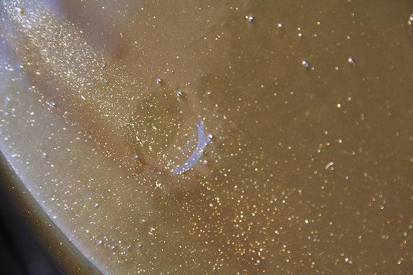

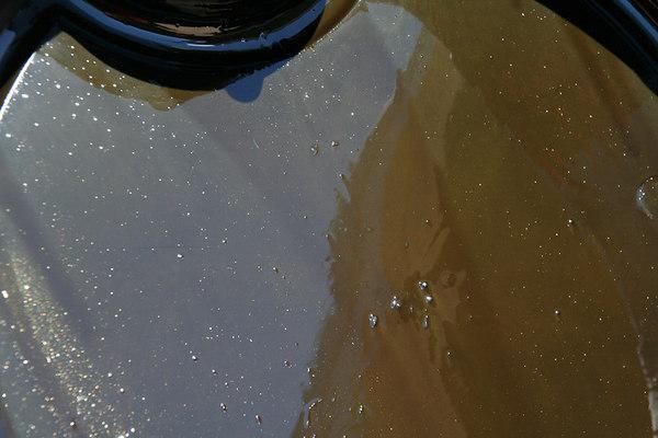

                          FWIW I changed the oil on our GTI after about 6000kms. Here's what was left in the catch tray...
                          More pics here.
                          MY10 S3 3dr
                            That looks more like a runny turd than sump oil I guess what you see is to be expected from a new engine, a lot of it was probably already sitting in the sump from the first couple of 100 k's of operation anyway, it's all the more reason though to change it earlier than at VW's recommended interval, for the first service at least.

                              Couple of tips to remember:
                              Never put funnel you are using for pouring the oil in the engine on the floor like in the photo, the same goes for the oil filter.
                              Keep the funnel in the sealed container or wash and dry it before use.
                              I buy more than one oil filter and the one I'm going to use next oil change I seal the box with the tape, so no sand and other dirt can get in.
