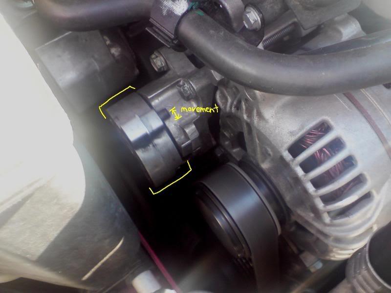

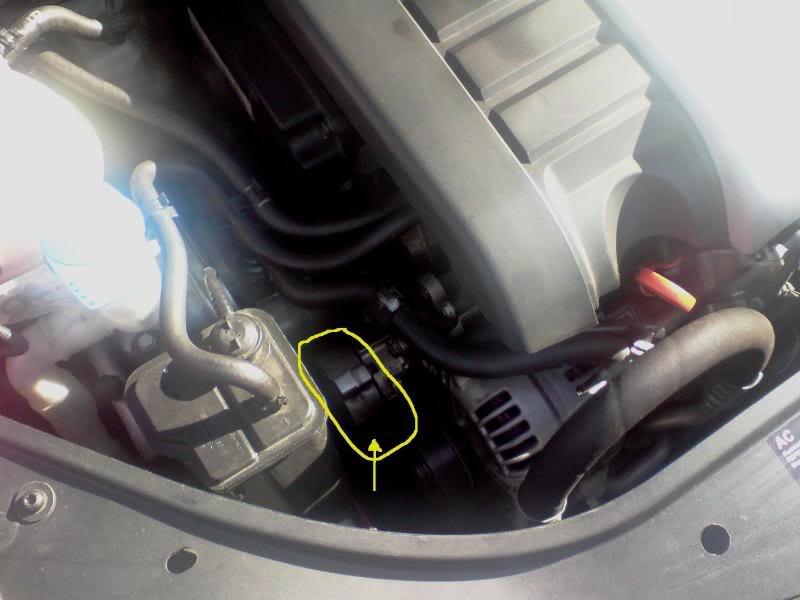

    Help, would anyone tell me what is the thing circled yellow in the photo attached?
    Car is 2006 Golf GTI
    It is rattling (moving back and fore) after a cold start making a weird noise.
    what wrong with it and how to fix it? After the engine warm up abit, the movement will disappear and the noise stop.
    Many thanks!

      Tensioning Roller.
      website: www.my-gti.com
        Cold belt probably gripping and slipping causing tensioner to jump around.
        Give a visual to belt and check tensioner is not loose laterally.
