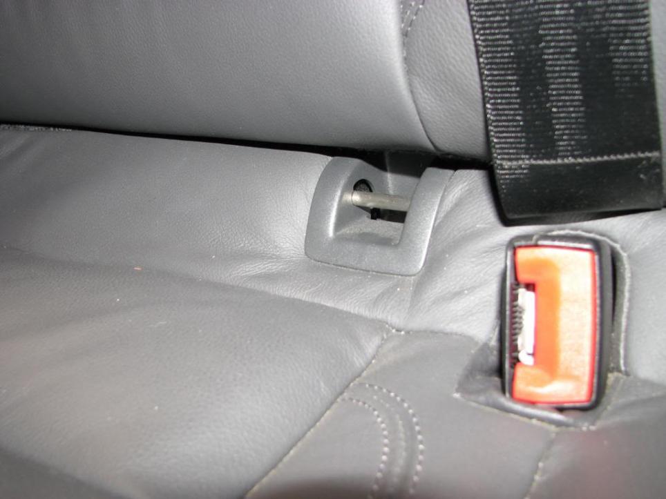

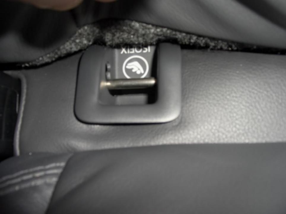

    I didn't get to inspect the car when I got it back as it was dropped back at my office and I was busy doing a stocktake so I've been inspecting the car today. I have a few issues to take up with them but one minor thing that doesn't look right is the plastic surrounds for the Isofix fittings in the rear seat. Mt recollection is that they were fitted in tightly originally but now they flop around loosely. Also the word Isofix is upside down and at the top of the surround whereas I think it was right way up at the bottom. I suspect that they have fitted these upside down and this is probably why they are loose. Would someone with a MkV please confirm which way up these surrounds go?
    Cheers
    George
    14 EOS 2.0 TSI has arrived!
    by the looks of it they've fitted it incorrectly, mine have the "isofix" wording on the bottom (On the seat part)..... They are also in fairly tight..... plus from those photos you can kind of see the outline of where the anchors should have gone...
    BTW not sure if they might differ from golfs to Jettas.....

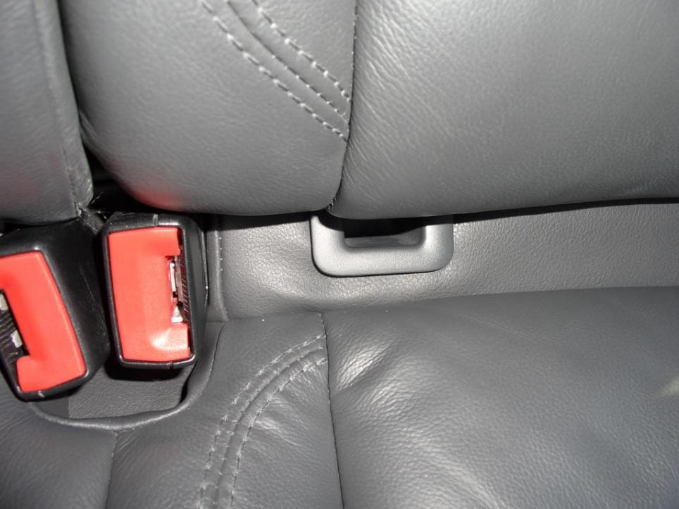

      Hi George, mine is an 05, there is no wrighting on mine but this is how they look.
      [IMG][/IMG]
      [IMG][/IMG]
      hope that helps
      Phil

        After having my back seat out and replaced with a GT one today, I can say they have definately put them in upside down . I'd be taking it back and getting them to fix it for you.

          Thanks guys, my suspicions are confirmed. Much appreciated.

              Double confirming ... yes the word "Isofix" should NOT be upside down and the fittings should all be tight.
