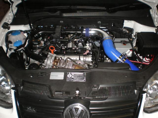

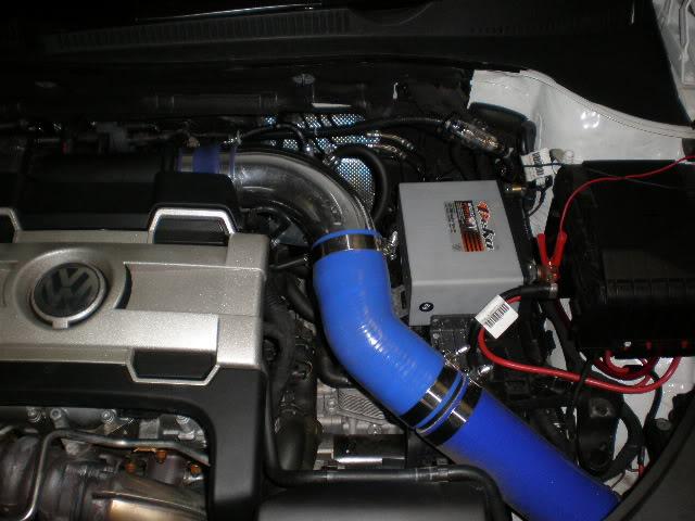

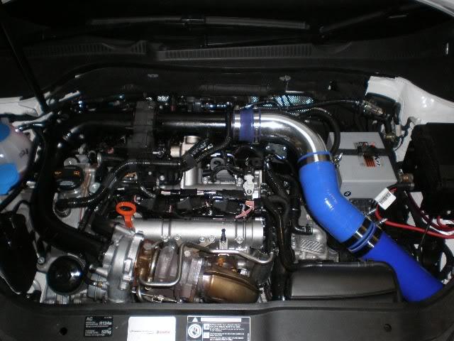

Want to shave 10.7kg from your car cheap?
Nice work thinking outside the box there, I always had a feeling that "racing" batteries were just rebranded bike and ride on mower batteries.80,000km 1997 MK3 VR6 manual for sale - www.vwwatercooled.org.au/forums/f23/80-000km-1997-manual-vr6-nsw-sydney-67658.html
Thats the irony. The box on my battery has pictures of harley's and sports bikes and ATV's and sea-doo's.
When you think about it... some of those motors in those things are more hp than my car!!! no accessories to drive but the thing is just to start it mainly.
The Deka battery tested 719ccamps right in front of me... while an oddyssey 680 tested 390ccamps on same tester machine. This thing is a WICKED quality battery and was $100 cheaper than the oddyssey.
You see most people go "oh i cant use that I am a car". I go "well, a bike has a motor too, same voltage, same alternator recharge, same purpose".
I have since looked online and this battery is popular in some BMW forums!*Disclaimer - Don't rely on me, seek your own professional advice. Audi R8 E-tron. 230kw 4500nm! (not a typo).
Economy at 100kph =5.5L
How much did it set you back, and where did you get it from?80,000km 1997 MK3 VR6 manual for sale - www.vwwatercooled.org.au/forums/f23/80-000km-1997-manual-vr6-nsw-sydney-67658.html
