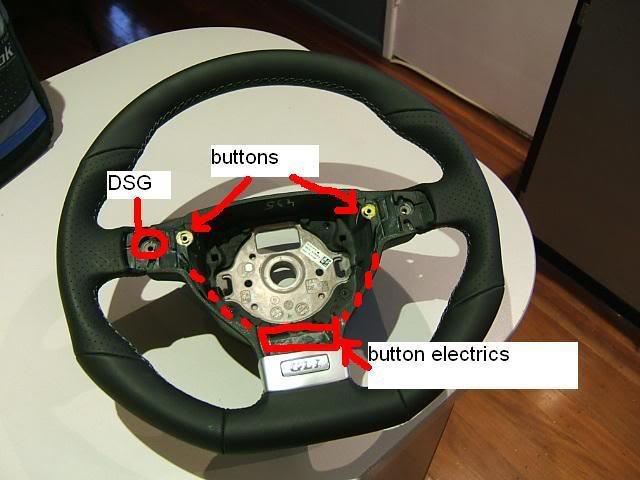

        EASY to fit, but you will need a special allen key to undo the main nut, and it's a bit less than an 8mm, so I just ground one down a little and it worked a treat. Unhooking airbags is dead easy, and anyone on here with Erwin or Elsawin manuals can help you out with the directions, but it's pretty easy. The trickiest thing are the clips on the horn pad, where you need a short flat blade, and a mirror to slide the clips outwards to unhook it. THAT was a bit tricky.
        If you have DSG you'll have a bit more to hook up, and you'll need to buy a DSG friendly wheel, as it has cutouts in the back. Also, some german wheels don't have the bolt holes for the steering wheel buttons, so make sure you know what to look for.
