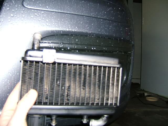

          But mate, go for it! I'm sure you can pep up the impressive TSI and it's that factor that had me set on buying one actually ( until I tried the Jeckyl/Hyde TDI that is! ). Plenty of things to tweak, but as per any forced induction motor, the thermal capacity of the engine would be my first port of call, and it's exactly what I'm up to with the TDI. Been a quiet few months thanks to flippin interest rates and the like, but currently talking to Plazmaman about a nice Water to Air core, and about to run some tests with a nice 4 input digital thermometer I just bought on e-bay. Will let me monitor temps from four spots, and most importantly across the stock air intercooler. Coupled with my rather large industrial pressure gauge, I will have some data for both temp and pressure difference data across various portions of the VW inlet and exhaust. Boost guage and EGT about to be hooked up too, so it's mad scientist for the next few weeks for me!

            Good idea cogdoc. I think water to air core is a great idea.

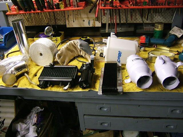

            I was thinking you could whack a small one in somewhere on the intercooler pipework under the car and then just run the water lines to a pump thats run off ignition and to a race oil cooler mounted in a row behind the bumper.
            I was thinking about this whole idea.... and then I thought, might as well just buy the forge twintercooler for the TSI when they release it finally, they have pre-production pics on their website.
            One issue is that you should not remove the factory intercooler and replace it with teh water core as this could change airflow so much that you would need a retune... .if you just add it in addition then it will reduce flow slightly but u will get heaps better inlet temps and more power. No need for retune then.

              At First I toyed with the idea of two small cores, before and after the stock air to air, and was considering Lindsey racing ones, but on reading some japper turbo mags, Plazma sure sounds like what I'm after.
              I figure one post Air to air, down low so it doesn't heatsoak is the answer. There's room in the TDI, unsure of the TSI situation. I found a KTM50 motocross radiator will fit with a little metalwork behind the passenger fog light shroud, and had figured this would be my setup. I'm sure any 50cc or similar bike radiator would be a potential, this is what was on e-bay at the time. This way I'm not adding ANY extra heat to the Air 2 Air.
              Then I thought of putting the water core out front like your pic shows, and using the air to air as the water radiator for this core. Will have to put some thought into your suggestion, but I'm lost as to why the path or volume post turbo would be a problem, as it's under p[ressure, is it MAF calibration??

                  The reason you cant just bypass the original factory intercooler is that if you fit just the water to air core, it may be far more efficient than the factory intercooler in terms of its airflow volume.
                  The problem would be thus: Turbo pressurises the air, it rushes into the water to air core, this flows much faster and easier than the factory core and now boost arrives at your inlet manifold 800rpm earlier than expected. Your computer tries to compensate by increasing fuelling but it maxes out its small adjustment capacity and now you are running slightly lean down low because boost is coming on so much sooner.
                  ALSO!!!! Your MAF only works in closed loop when you are at low throttle and cruising. When you go WOT it flicks over to open loop (just uses whatever values are in the computer and adjusts using oxygen sensor). So even if the MAF can compensate at low speeds it will be doing stuff all once u go WOT and your engine could grenade.
                  Get the picture? it would not be good without a custom tune.
                  BUT!!! if you just fit the water to air core after the normal one, you will just be increasing the lag slightly and this couldn't possibly cause issues as the car would be expecting slightly more air than its getting and you would initially just run a tad rich and then it would compensate. Therefore, it would still be safe and productive, you would just get a nice increase from chopping 10-15 degrees c off the intake air to the manifold.
                  The benefit of the water to air core is that it works more independently from airflow through the front grill.
