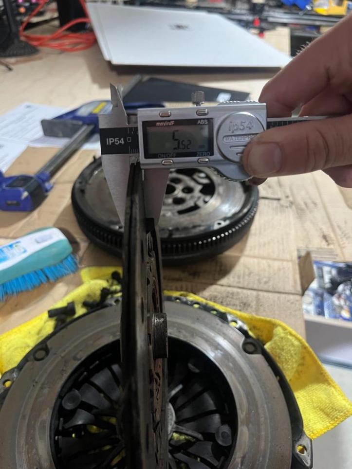

    OEM dual mass flywheel on my MK5 GTI has finally been replaced after experiencing minor slipping problems. I’ve been APR stage 2 for over 150,000km and engine break, I rev matched fairly well too. Worn down to the rivets
    Here’s some photos for you curious folks

      Was looking at Saches sport and the rsr clutches. Ended up going with a HardingPerformance mk5 clutch with a SMF purely cause I don’t have time to order in.
      keeps door open for going stg3 too. Pedal is much smoother and it’s a bit easier to rev match. Occasionally noisy but can barley hear it
