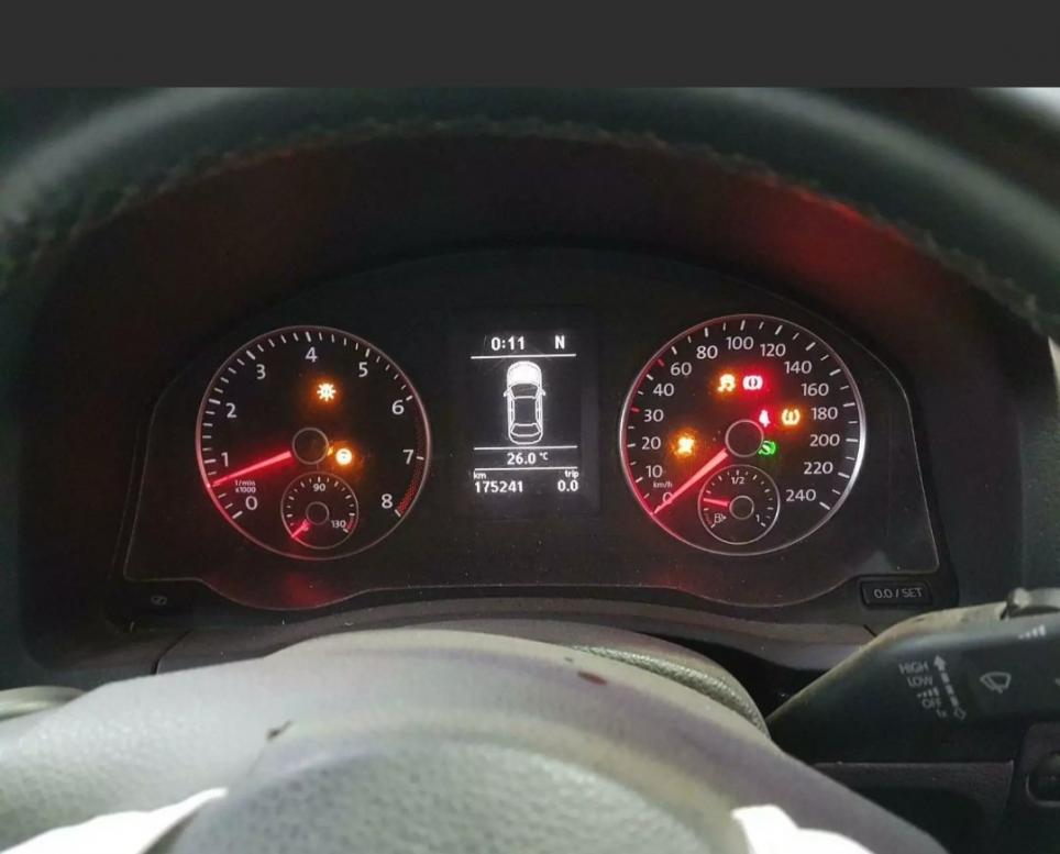

                    This unit would fit with the harness adaptor... As its from a jetta with a mk6 steering wheel would I lose all functionality of my current steering wheel buttons?
                    My guess is yes but maybe somebody can confirm?
                    Sent from my SM-G977B using Tapatalk
                      I believe they will still work.
