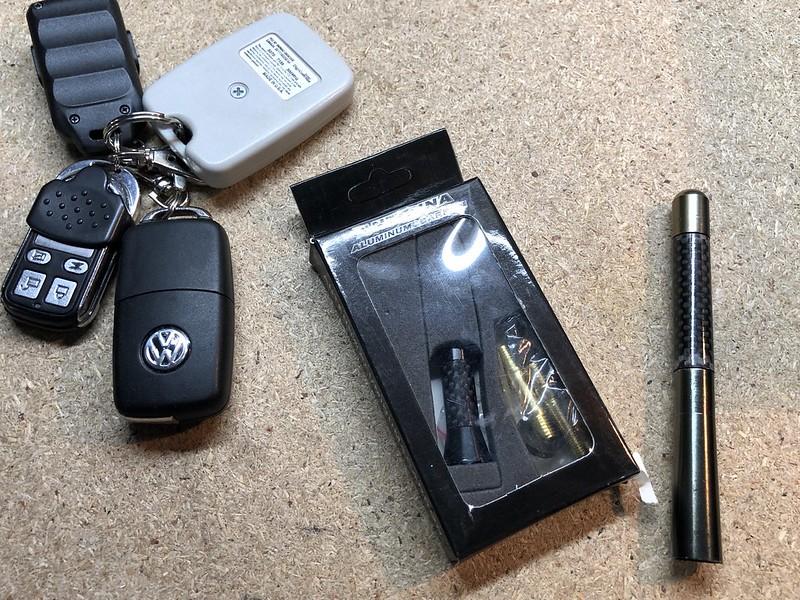

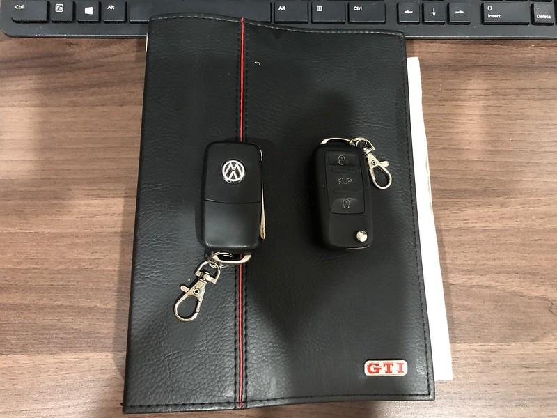

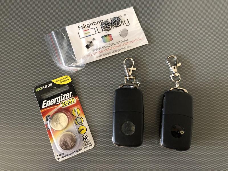

    I gave the remotes a minor refresh with new batteries and some new vw logos...
    decided to get rid of the longer aerial and fitted the little stubby one which doesn't stand out as much...

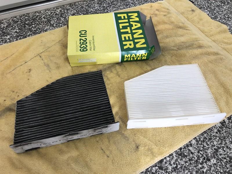

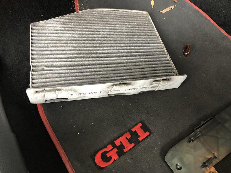

    replaced the cabin filter as the inside smelt of dog, old socks and boll locks. old mate cockroach dropped out with the old filter, if you look close it looks like he's wearing shades...
    old vs new, probably looks worse than it is as I think the old one was a charcoal filter. happy to report after a good vacuum and spraying a can of deodoriser down the aircon vents the smell has now gone...

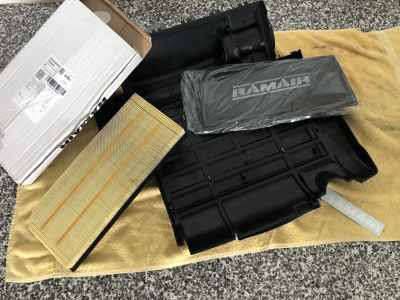

    replaced the air filter for a bit more noise and an extra 1000 bhp. the previous owner said he'd just replaced the air filter which I'd believe from looking at it so I hope that means he's legit about all the other service items he did...
    hard to tell but the plastic air intake was missing one of its screw fixing tabs; the one on the back right...

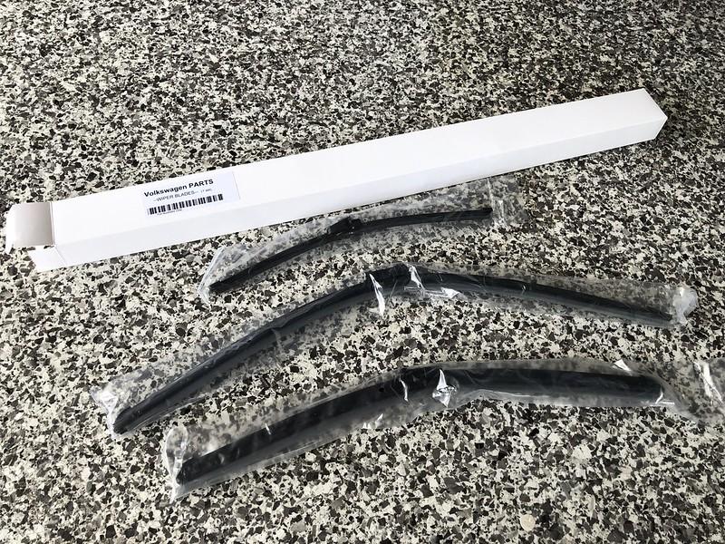

    not that exciting but there's something nice about using new wiper blades...

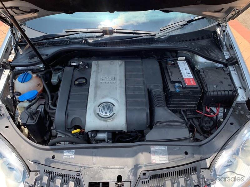

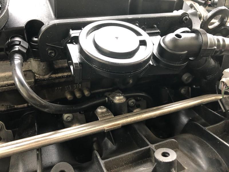

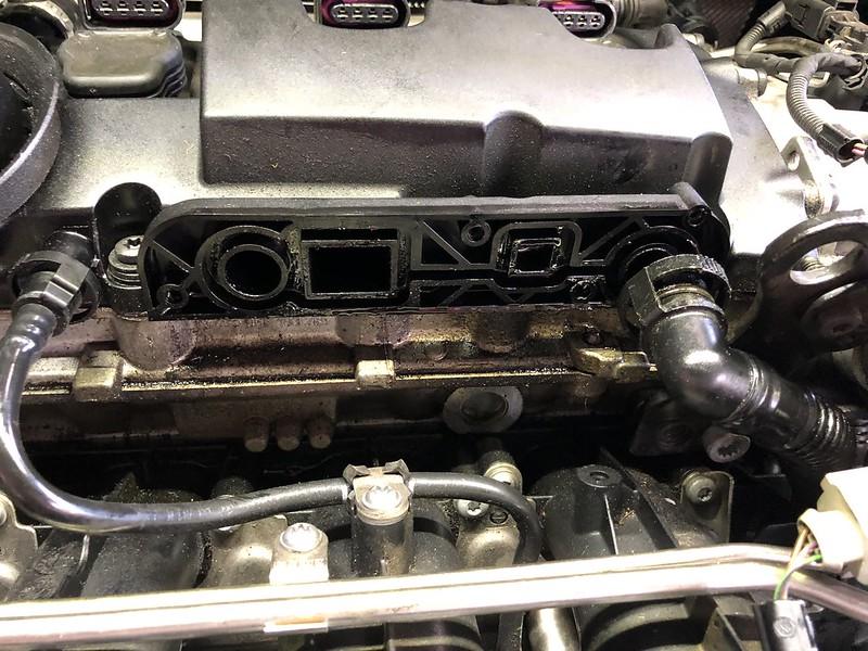

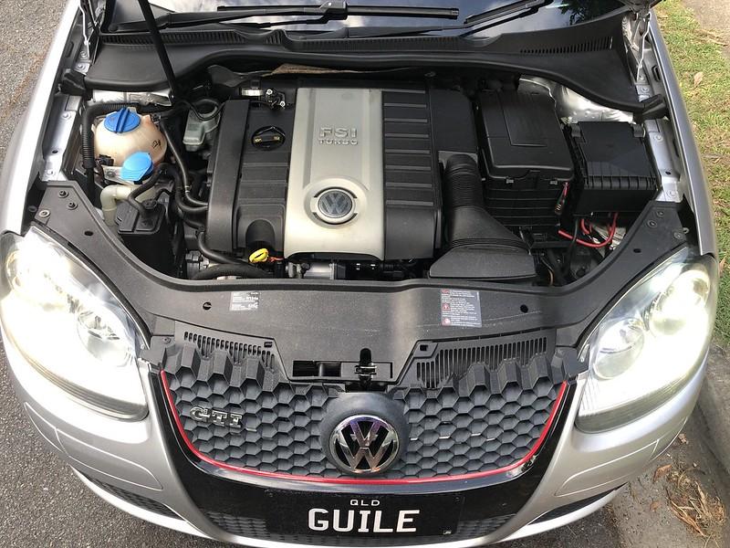

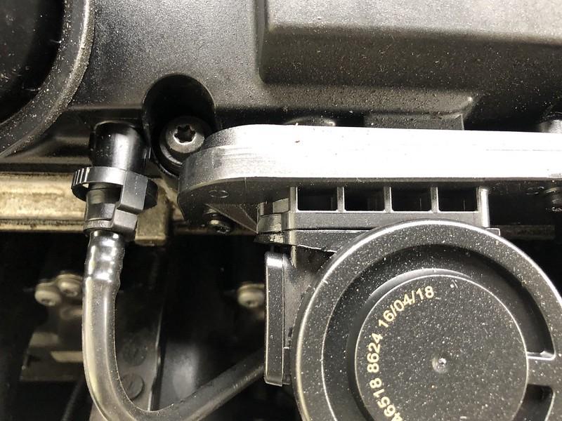

      I popped the engine cover to get a good shufty at what was underneath. it looks like oil residue around the pcv that has supposedly just been changed...
      I did notice that one of the screws heads is not sitting flush with the pcv mounting face so not sure if its not seating right and don't know if the gasket has been replaced at the same time or not...
      I plan to remove it again, insert the new gasket and seat the screws properly. I will clean up the area and monitor it to see if its still vaping like a boss...
      I also noticed that one of the coil pack electrical connectors had the clip broken off. I've ordered a new connector and will push the pins out of the old one to replace it and prevent any new wiring needed...

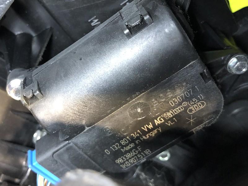

      the only code I get that I can't clear is one for the HVAC. apparently its this motor that is kaput so I've ordered a new one and hope that fixes it. its a common problem i hear so it should be all gravy once its swapped out...

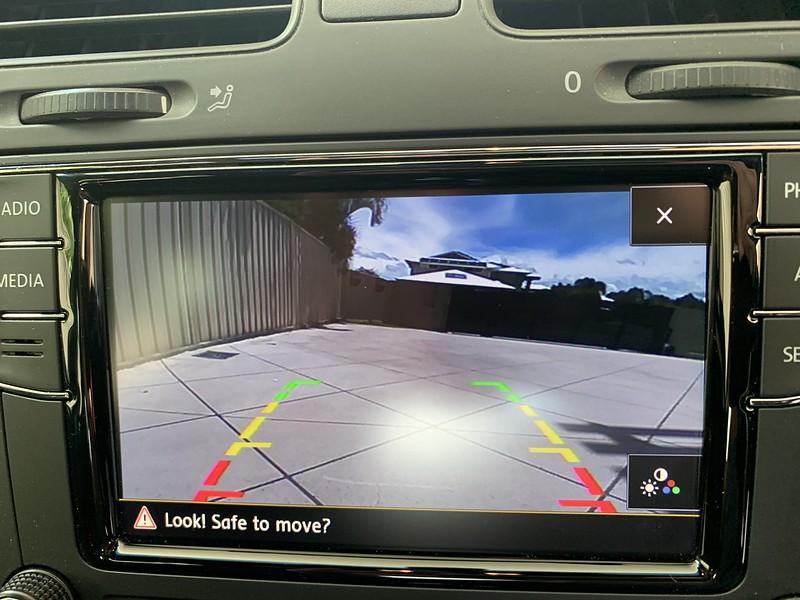

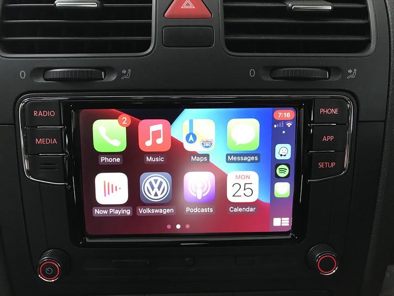

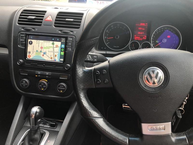

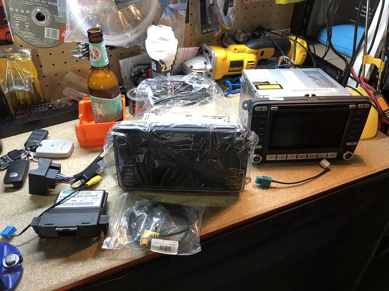

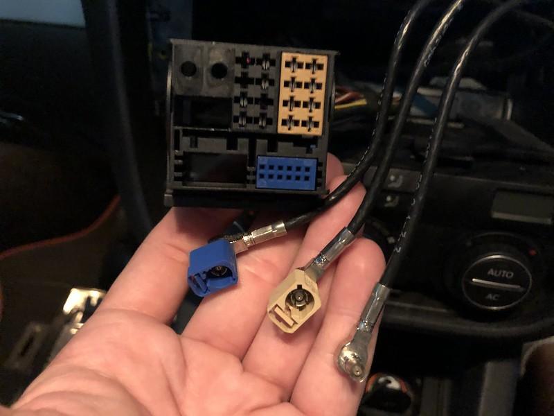

        I bought an rdc330+ and although it might sound a bit silly to spend $350 on a headhunt for a cheap car I reckon its the best $350 I've spent in a long time. having Waze at your finger tips and Siri to do what you tell it without pressing a button is awesome. Waze has saved me a couple of times so the $350 has already paid for itself...
        I also bought the steering wheel control adaptor, can bus controller to stop my battery draining and a usb connector which will sit down near the ash tray...
        they throw a free adaptor in for the aerial connections and free connector for a reverse camera. I was a cheap skate and used a camera that replaces one of the rear number plate lights but it works awesome and comes on and off without fail when selecting reverse and drive etc...

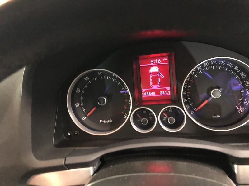

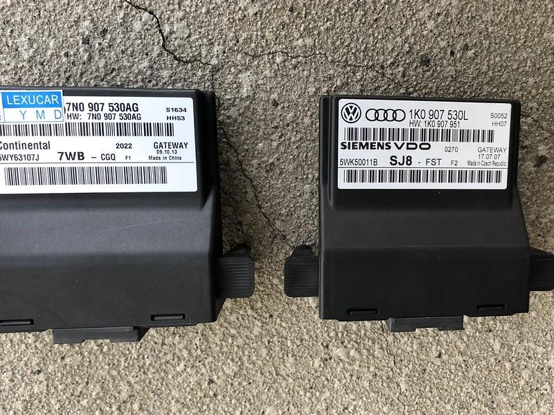

        coding the new canbus gateway was a bit of a headache as it doesn't work like the old one with long coding. you just go in to vcds and select all the control units applicable to your car. you also have to switch the LHD / RHD thing. it was funny when I first turned it on and the drivers door was open it showed the passenger door open on the DIS, I thought I'd broken something...
        the 8 button steering wheel requires the adaptor as noted above. it works ok but the slightly annoying thing is if you skip a track or radio station it skips the DIS to the next function as well...

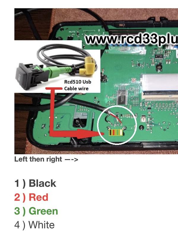

        This is the soldering I need to do to get the usb input down in the ash tray. I'll post some more photos once that's done and include the reverse camera install too...

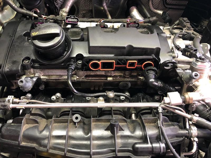

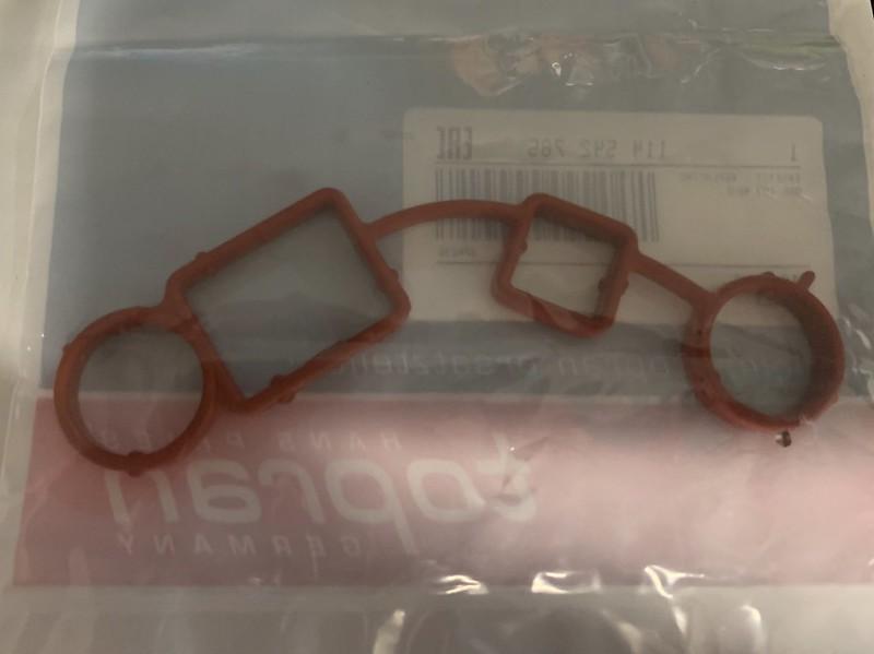

                some very minor updates but progress non the less. got around to fixing the previous owners pcv replacement bodge...
                cleaned and with a new gasket, its no longer leaking...

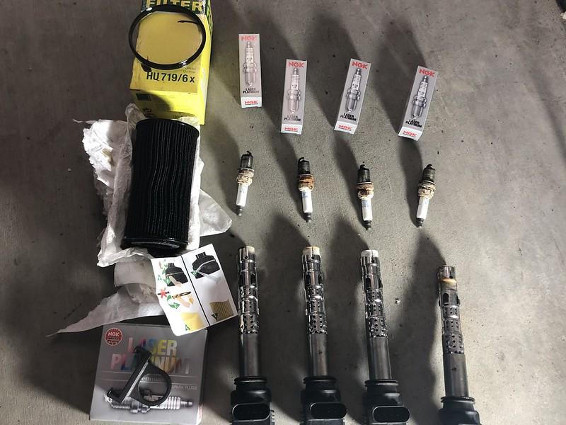

                I also gave it an oil and plug change, not before time by the look of the oil filter...

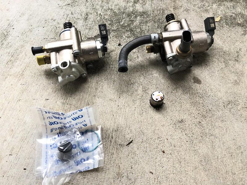

                I also swapped the HPFP for one I had on the shelf with uprated internals. replaced the cam bucket and o ring at the same time...

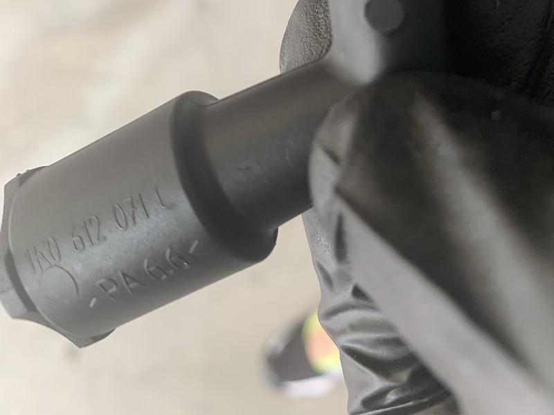

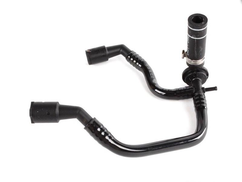

                while doing that I noticed another bit of handy work, referring to the black electrical tape...
                I recorded the part number...
                and ordered one of these...

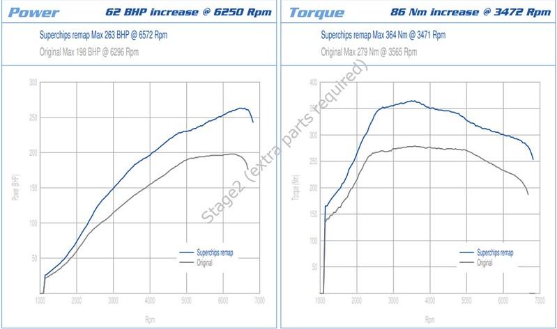

                once all that was done I updated the Superchips tune to stage 2+ including the crackle map for a bit more noise. this also cured my sporadic eml flicking on and off which was part of my justification for doing it...
                feels fairly quick enough for a daily now and an awesome easy drive with the dsg...

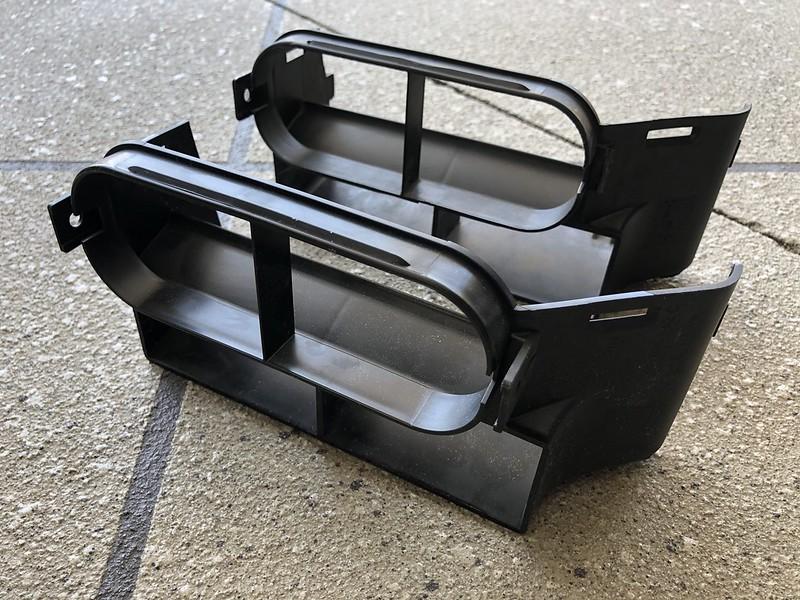

                  the out of shape crumpled firewall shield had been bugging me for a while so I thought it was worth 50 bucks to replace it...
