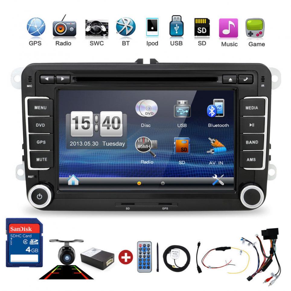

    I have looked through this forum but was unable to find the specific help I was after, basically I am wanting to upgrade my car's head unit but I want to stay in line with the original styling of the VW fitted stereo.
    I have done some research online and found a couple of potential options but most of them have warnings such as 'disables steering wheel functionality' or they look a bit dodgy.
    I was wondering if anyone here has any recommendations for upgrading my head unit to a model that has Bluetooth, aux, and usb functionality? And if possible GPS but that isn't a must have, but has a similar design as the current one and still allows for the steering wheel buttons to work.
    Here is an example of one I found online:
    I was hoping not to have the break the bank and second hand options would be perfectly okay! Ideally looking to spend around $200-300aud but can go higher if needed.
