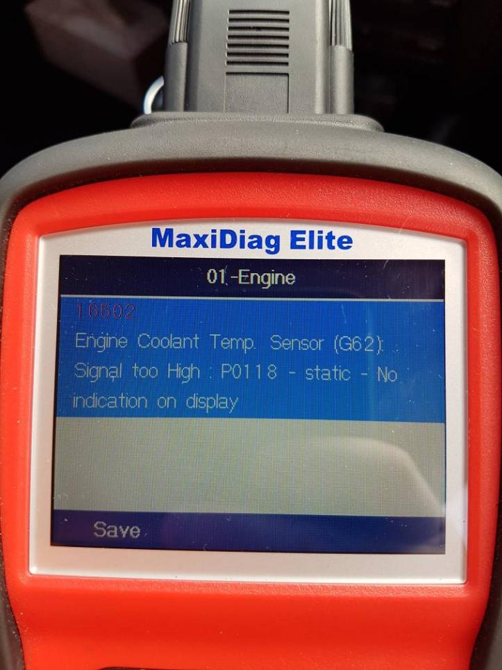

                So connected the Autel Scanner and ran the diagnosis test.
                All that came back as an error code was the coolant sensor. So not sure that the temp sensor would stop the car from starting.
                Anyway ill that the opportunity to throw a new sensor and coolant in over the weekend ready for summer.

                  It can happen on this era VW, but it's not common.

                    even when I had a coolant sensor warning because I was refilling after flushing it, the car still started and ran. But different engine so maybe

                      I brought a new PAT coolant temp sensor (updated green version) from burson 3 weeks ago. Never got the chance to install it as have been away with the kids for holidays.
                      So what do you know it cut out again in the driveway this afternoon as we were about to leave for dancing. So took the chance to replace the sensor. Moments like this I have to thank my tiny office hands as its a bastard to get to even after moving a few of the surrounding cable harnesses.
                      As soon as i turned the ignition on I could here the circulation pump working which is a good thing as I never heard it working before. And she started 1st go to so happy as larry.
