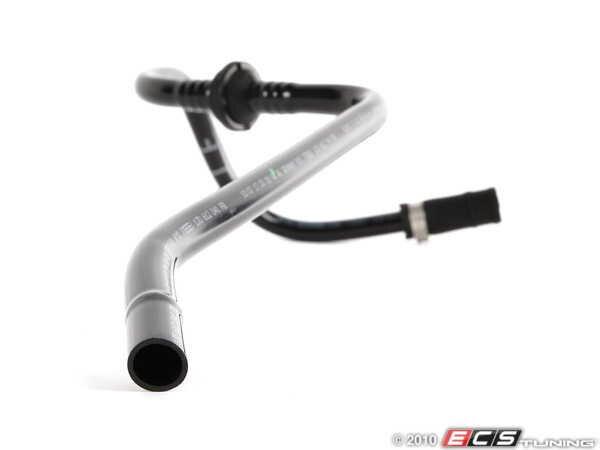

    What is the correct operation of the brake booster check valve found in the hard vacuum hose that originates from the right side of the intake plenum. Picture added.
    Does the check valve prevent positive boost from flowing further up the vacuum line?
    I'm leaking boost from the opposite end of the vacuum line. Just wondering if boost should be going through the check valve.
    Thanks.
    I think I'll answer my own question.
    NO, boost should not be going through the check valve.
