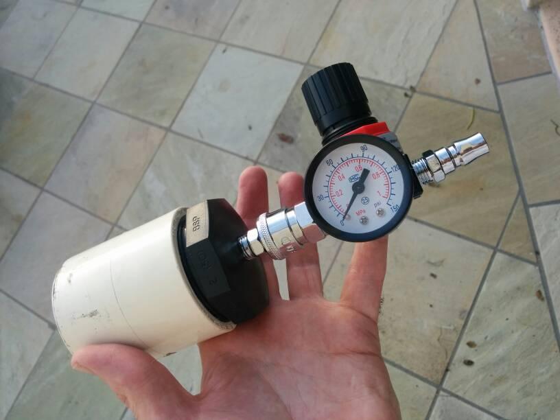

    • I fabricated up an attachment to connect into my TIP with a nitto attachment on it to connect to an air compressor.
    • I set the air to be regulated to the minimum setting.
    • I also unplugged the hockey puck and plugged the hole to avoid pressurising the sump.
    • Do i need to do anything else?
    Anyway I start the test, and I get a really high pitch whistle happening!!!! Similar to the sound i hear at full boost but a mega version.
    I freak out and then unplug the nitto coupling which makes the big whoosh sound.
    Please watch and if I am doing anything stupid please let me know....Does it sound like a boost leak somewhere?
    I'm scared to do the test again in case I'm damaging something.
    How do you regulate only a certain amount of air into system? Eg. I only want 1 bar of pressure for the test.

      Yeh no regulator which is obviously not ideal which is why I set the air pressure to minimum.
      And yes oil cap was off, I forgot to mention that.
      I'm pretty sure this is what I need. Can you confirm?
      Air Pressure Regulator Relief w/ Gauge Hose Quick Release Compressor Fitting 1/4 | eBay
      I'll make sure my boost leak test is 100% accurate before proceeding.
      Sent from my Nexus 5 using Tapatalk
        yeah rok that do it!
        taper pressure up in lots of 5 to be safe if your paranoid..i would just smash it with air and zone in on that fkn farting noise personally,least you know its there and not in your head lol..these rides do your nut in!
        DEEP POCKETS NEEDED
          Ok I ordered that to help out.
          I have noticed my turbo inlet pipe does not have a clamp on it.... i guess the coolant hard line keeps it on. The pipe is under vacuum, should I put one on?

                      UPDATE: Boost leak detected with newly upgraded leak tester.
                      It was a coupler used for the intercooler piping, it started leaking at 5psi! So at 20psi would be mental loud.

                        What size fitting did you use for the leak tester?
                        Also what did you block off to do the test? Oil cap off, pvc pipe clamped shut?
                        MY MK4 BUILD
                          What are you referring as the fitting?
                          Both the threaded pvc tube and the end cap i bought from Bunnings, The thread for both of these is like an inch long.
                          The PVC tube fits my APR silicone turbo inlet pipe perfectly. Clamp it down TIGHT because the PVC pipe does not have a lipped end!
                          I drilled a hole in the top of the black end cap a fraction smaller than the threaded Nitto style male coupler. I then forced the coupler to create its own thread in the black end cap.
                          All threads I used plumbers tape to ensure no air leaking.
                          Oil cap off
                          I remove the hockey puck from the TIP, and then clamp a Co2 canister in there TIGHT!. It is a perfect fit, but watch out it doesn't slide into the TIP and make sure it does not become a missile.
                          https://i.stack.imgur.com/OVvrz.jpg
                            UPDATE: Just logged my car and I still have boost leaks. n75 duty cycle still maxxed out.
                            HOWEVER, The car is much better thou as acceleration is really strong through the rev range. Kinda crazy to think there is still more power after I finalise these leaks. I really think I am down to the tiniest of leaks now.
                            I only tested to around 7 psi today because my TIP clamp is quite stuffed.
