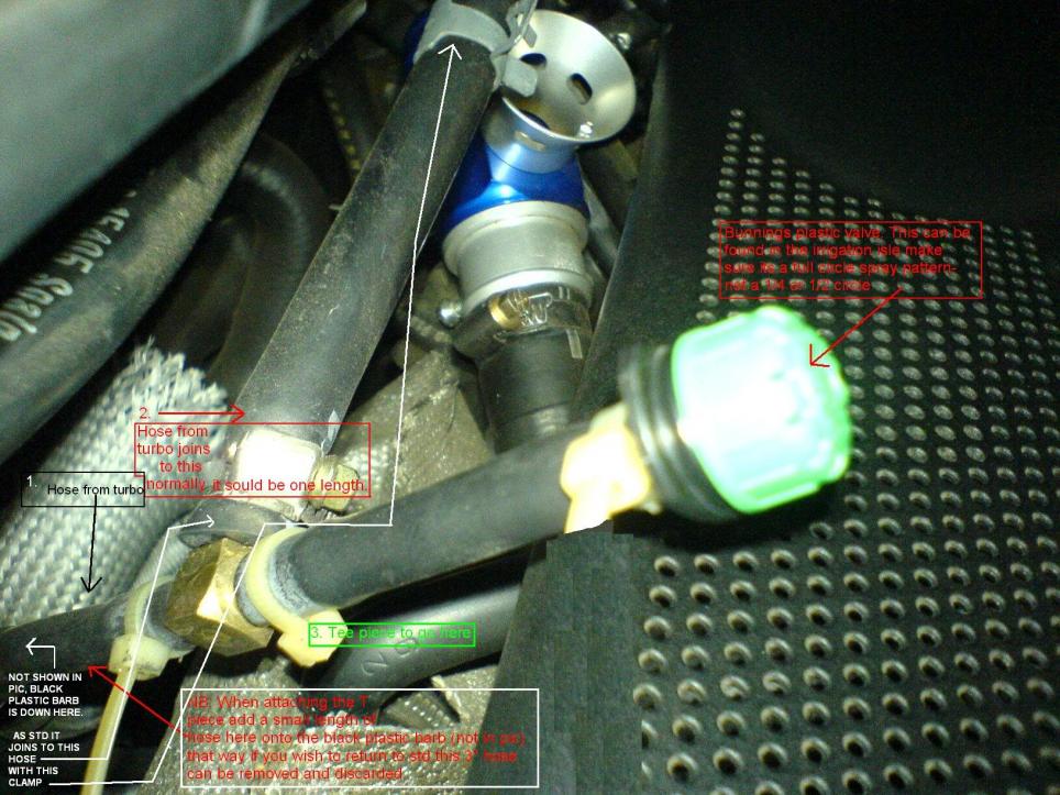

                        Anyways, so far I have fitted a drop in Pannel K&N filter (i still have to remove the air box and smooth it out+fit the cold air feed from the base of the bumper) and a 0.59c manual boost controller it sounds crap but it does what i need for now, it holds 10psi with no issues and looks ok-
                        Its amazing what a difference the small boost up makes...id recomend it to anyone!!

                          And to think that engine is now in the polo gti :twisted:

                              ok here goes, but please only do this if you have a boost gauge, well with this valve so long as you keep the green section screwed on it cant really exceed 12psi ive found anyways(but I still recomend a boost gauge!)
                              I have mine unscrewed till the last click before it completly comes off (That way it cant blow off[I suppose if its set to what you like[either lower /higher] you could apply a drop or 2 of epoxy if you are worried])
                              So you will need
                              1 Valve
                              1 Tee piece (plastic/brass[better])
                              Some small hose clamps (Im lazy and havnt replaced the zip ties!! )
                              Locate the Hose that comes from the actuator on the turbo ( It comes up from the turbo area, You will notice that there is a press fit clamp half way and the hose comes apart at this point-pull it apart.
                              There is a black plastic barb pressed and permanently calmped to the turbo side of the hose which you leave.
                              Now with the section that you have seperated add about 3" of hose to the black plastic barb then fit the TEE piece to this hose.
                              Get the factory hose that you pulled off that black plastic barb and press this onto the TEE piece also (at 90degrees to the 3" hose) this should leave one of the TEE piece barbs free.
                              On the last free barb of the TEE piece fit another 3-4" of hose and then insert the bunnings valve on the other end.
                              Go and fit small hose clamps to all connections and tuck the valve behind one of the other hoses on the firewall just to give it some space from the heat of the area.
                              Thats it. Screw it all the way in (no air stock boost) and then unscrew it in sections untill you reach the boost level you want.
                              NB: Provided you dont completly remove the green cap on the valve it shouldnt exceed 12psi but this may differ on your car- so be sensible.
                              Ive had mine fitted for 6 months and havnt had any issues.
                              I know my instructions are a little rushed but you should get the idea if not shoot me a msg.
                              Happy boosting

                                s14s2a - I approve of the bunnings methodology!
                                Homebrew mods are always the most satisfying...
