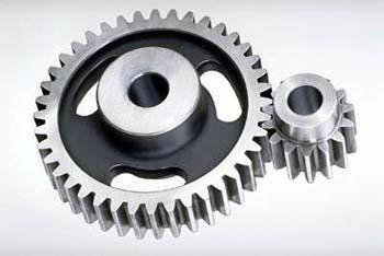

      Your forward driving gears are Helical cut with synchros (Gears are on an angle so when you put the gear in, it goes in nicer and has less noise), In just about every vehicle the reverse gear is a straight cut gear with no Synchro. Meaning when reversing you will get a whine out of the box because the gears have straight teeth therefore this makes for a noisier sound. If you ever watch the V8 supercars you will hear this all the time as they run Straight Cut Dog Boxes (or a variant) Most people in the WRX scene will upgrade their gearboxes to Straight cut boxes for example a PPG Gearset which I have in a 2000 WRX shared with one of my family members.
      If it is a whine you hear, it is completely normal, if it is louder than others it still is not a problem. When I was working for Mazda the 6 Range was whisper quiet however the 2 and the 3's were noisy as.
      If you search Youtube for straight cut gearbox or PPG listen to the noise and see if it sounds the same. I bet it does.
      I hope this helps and if there are any mechanical techno boffins out there, please correct me on anything I have said. I am an IT nerd after all
      Straight Cut
      Helical Cut

        So straight cut gears are stronger than helical cut ones?
            MUCH MUUUCCCCHHH Stronger.
            You can get a Straight cut box with Synchro's too so you don't have to rev match at all. In our WRX we have done 1st to 4th so for highway driving, you can go to 5th and have the quietness of the Helical cut.
              Just dont go flat out backwards and change the oil for a special gearbox oil that quietens noisy gears.
