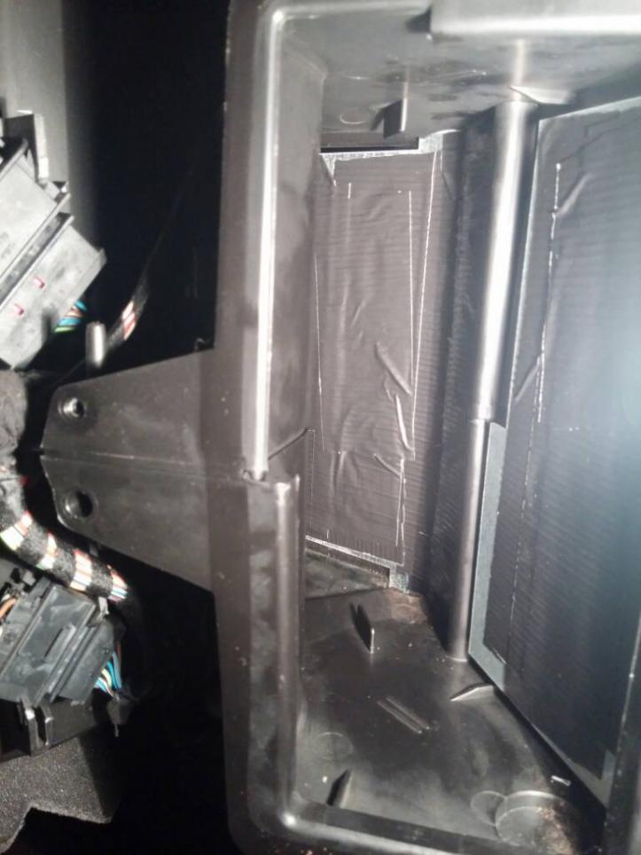

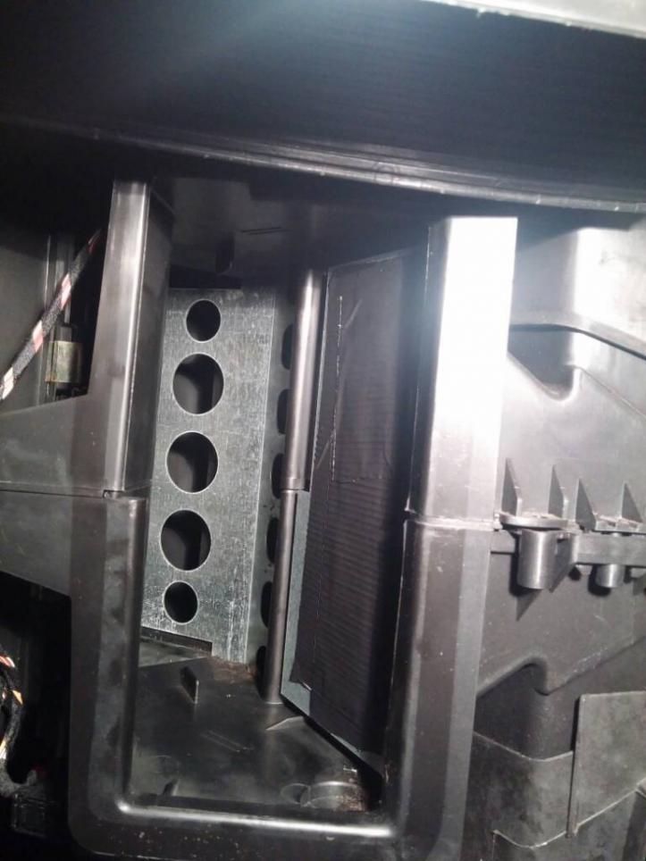

                    Added some pics of blend door fix.
                    All the gas stuff happens in the condenser bits the air itself never comes in contact with the gas.
                    The door allows the blown air to flow over either the cooled condenser or the hot heater radiator.
                      Thanks heaps for those pictures mate - timesaver!! Here I thought I have to rip out all my dash and muck around with aircon gassing and a new receiver/drier bottle.
