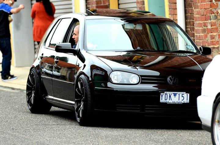

    Hey guys,
    Will be purchasing some Rota Grid's next week and I'm a little strung up on wheel fitment/sizes, I've gone through previous post and have a general idea of what people have gone for. I know I have a 5x100 PCD though the look I'm going for is as seen below
    Would these be a straight fit or would I need to flair/roll the guards?
    Current set up is below
    Any help would be much appreciated.
    Cheer's

      These were Rota 18x9 et20 all round (after 15mm spacers) with -1.5 degrees of camber and 225/40 tyres on the front and 215/40 tyres on the back, if that helps.
      The ones in your pic look a similar size. If you do get 18x9 et35 you'll need atleast 5mm spacers to clear your coilovers and if you go lower you'll need to roll the guards too

            Sorry to re bump this thread, so i found the specs of the wheels on the golf in the first picture though i don't quite understand what he means...
            Spec's are
            Rota Grids
            Gun Metal
            8.5J Front et42
            215/35/18's
            (15mm spacers front)
            9.75J Rear et35
            225/35/18's
            (20mm spacers rear)
            (Nankang NS2's)
            http://www.swdubs.co.uk/forum/viewtopic.php?f=37&t=17732
            Anyone able to help me out as I'm ordering these this week, on the ROTA site i see nothing along the lines of the of the spec's mentioned above.
            Sorry new to all this so any help will be greatly appreciated.
              So I've decided to go with 18x8.5 ET44 grids on the front and 18x9.5+38 grid R in the rear, hopefully it will give the car a more aggressive stance, the guys at Tunehouse said I'll prob have to add spacers and roll the guards.. Anyone ran similar wheel sizes?

                Guards will definitely need to be rolled and front will definitely need spacers man if you're gonna run coilovers.
                I'd personally go with 40 profile tyres instead of 35 with about 10-12mm spacers on the rear and 20mm on the front
                  Hey Slaj so your wheels have an offset of +35? Then the 15mm spaces on top to bring it to 20? Just double checking because want to be sure about fitment on my wheels. Would it be same fitment on my GTI? And did you roll your guards?
                    Hariso you can run 10's on the rear without rolling

                      Yeah they were 18x9 et20 all round man. Did definitely have to roll guards and ran 215/40 on the back and 225/425with camber udjustable strut tops on the front to fit the tyres under the guards
