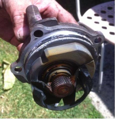

    Had the same thing with my old 1.6 blamed everything but it ended up being the waterpump impeller. when was the timing belt done? i'd put $10 on it's that. easiest way i checked mine was pull thermostat out and stick your finger in the hole (lol) and see if you can spin the impeller. if you can then it's come apart from the actual pump and isn't moving any water.
    Pic for reference: Mine when it came out. :l

      I don't know when the belts were last done but I have a feeling you're right with the water pump being the issue so I'll check it out, thanks heaps mate!

            Fixed!!
            cheers to everyone that suggested the water-pump! i pulled it apart and the impeller had slipped off and was very weak and as soon as i grabbed it, it would just crumble in my hand. plugged in the new much stronger pump and will hopefully last me quite some time

              Helps when you've been through the exact same thing! Glad you got it sorted mate.
