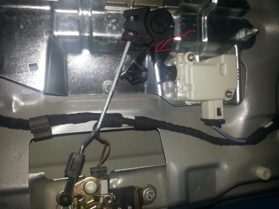

    Yesterday morning got stuff out of the boot and closed it. Went to put something back in it and it wouldn't open.
    Made the motor noise like it was trying to open.
    Tried using the key to open it and it didn't work.
    Tried unlocking and relocking it and it still wouldn't open.
    Got home from work last night and pulled the boot lid trim out and found this:
    This stupid bit of plastic is broken. Why is it plastic? No one knows...

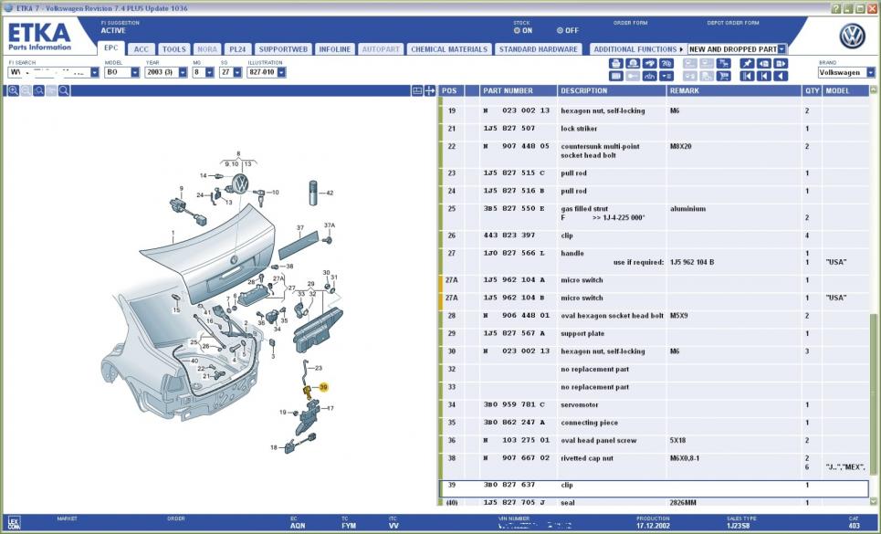

    Called VW and the friendly guy there emailed me this.
    So I figure I need item 33. However cant buy that part by itself- need to buy item 29 (Part No 1J5 827 567 A)
    This was quoted as costing $124.15.

      The dealer has sent you a screenie of ETKA - VAG's online part list. It's amazing. If you need it for yourself go to partscats.info
      For the widest choice of OEM parts check out [url=http://www.ecstuning.com/]Ecstuning.com[/url] or Pelican Parts - Porsche Parts & BMW Parts & Mercedes Parts - Automotive Parts and Accessories - Porsche & BMW & Mercedes.
      Anything mechanical you can also get parts from RockAuto Parts Catalog
      As for quality concerns - Yes, the part is plastic, but it has lasted at least 10 years, so unless you want to keep this car for anouther 10, I'd say a plastic replacement should be fine.
      From what I can see on ETKA and other sites, to replace the plastic clip, you actually need No.29 - it is the support plate, but from what I've seen; it comes with the plastic piece that's broken on your car.

            the ebay part broke in exactly the same way as the previous one did last weekend. So the part last almost exactly 3 years. My dodgey hot glue gun reinforcement didn't work.
            I ordered another ebay special to replace this one.
            I found out that you can open the boot by using the key in the boot lock and turning it all the way to the left... and then a tiny bit more and then holding it there.
            I also used a combination of super glue and zip ties to temporarily fix it.
