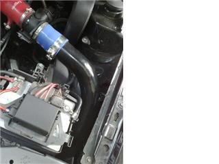

        NGOLF.U, mate how long ago did you do your CAI mod? Just wondering if it could have something to do with how you have positioned your control module after removing it from the side of the stock air box. Apparently positioning this in certain spots can affect your car with difficult starting because it's sensitive to temperature. Might be off-base but just a thought.
        Snowy.
          thanks snowy,
          yeh i have looked at that, the car began to miss-fire at one stage, so i played with that module and the miss-fire stoped immediatley. has not done it again since.
          do you know of a better place to keep it.
          you can see it hanging off the pipe just before the TIP.
          either way im going to replace the temp sensor as its cheap.
          MK4 GTI|REVO|4BAR ADJ FPR|APR FMIC|APR R1 DV|TURBO INLET PIPE|KONI|WHITELINE|CUSTOM CAI + K&N|2.5" TB + HI FLOW CAT| ECS DOGBONE
            I have mine zip-tied to the plastic cable ducting going into the firewall next to the shock absorber mount, so it's a bit further away from the action, not sure if it would be any different though.
            Snowy.
